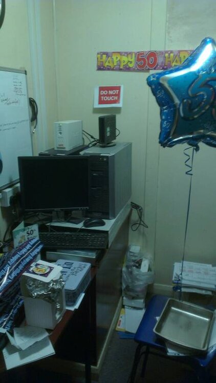

We only have a small server room / cupboard! and temps have been on the warm side of late. We are to get the room enlarged slightly but this may not be till next summer and I dont think fixed aircon would be on the list how ever much I would like it to be. Can anyone reccomend a small portable aircon unit that tbey have used and did it actually do the job. Our only cooling at the moment is a fan on the floor and the glass above the door removed! Does not really do much apart from move the air but its better than nothing. Got a spare server to 'play' with but cant as it generates too much heat! Currently have 2 servers and a PC running in the room.
Image does not do it justice but not much more room than shown.
