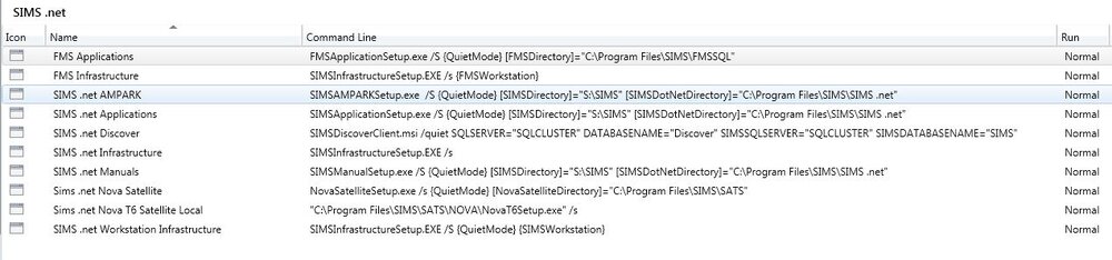

TheScarfedOne Posted July 14, 2014 Posted July 14, 2014 Here are the programs I use in my SCCM package. This is pointed at a folder containing the Setup executables and signature files.
rob998 Posted July 14, 2014 Author Posted July 14, 2014 Here are the programs I use in my SCCM package. This is pointed at a folder containing the Setup executables and signature files. [ATTACH=CONFIG]25609[/ATTACH] How do you copy the connect.ini files to the machine?
TheScarfedOne Posted July 14, 2014 Posted July 14, 2014 How do you copy the connect.ini files to the machine? Group policy

Sam_Brown Posted July 23, 2014 Posted July 23, 2014 I do similar to @theSacredOne although use a batch file instead of calling each setup individually. Using the batch file also means I can copy the connect.ini and sims.ini at the same time
