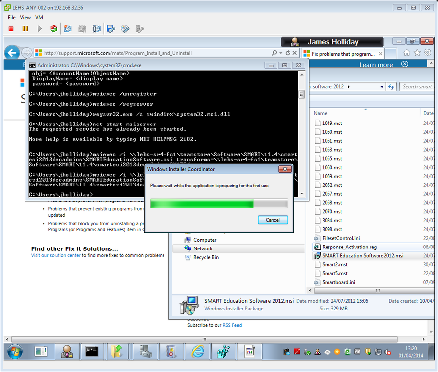

Issue: Due to a corrupted installed SMART Notebook 11.4 (without drivers) hangs on the "Installer Co ordinator service, please wait while the application is preparing for the first use". I cannot get SMART installed at all on server 2008 R2 x64. I am guessing this is probably because either windows isntaller is corrupt or there is another installation which is making the process hang.

This stopped the windows installer coordinator from appearing but the installer just hangs as it does before. Next I thought do I try and repair the windows installer? Don't really want to do anything that is going to make the server unusable.
Any ideas here? Please see picture attached.

Also I should add I have checked event viewer and I get the following:
Failed to end a windows installer transaction Error 5 occurred when ending the transaction.
assuming its basically the same as vanilla terminal server the terminal server wont allow multi msi installs to complete but i cant remember off the top of my head ow i fixed it
@sted thanks for your reply I think you may be correct. I thought the same when I read about applying the GPO but it didn't work all it did was to stop the attached message from appearing but the installer still failed.

Just to let you know I was able to fixed this It was a mixture of turning off the multiple install GPO but also I ran a different installer. I found that the MSI extracted itself to two installers and I had to install SMART Common tools and then the SMART Education Software.msi.
