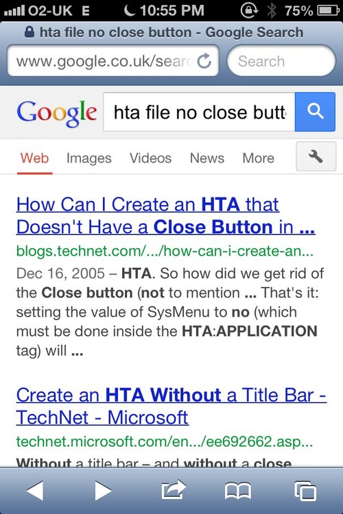

Perfect! Just tested it and it seems to work exactly how I want. Is there a way to say closeButton="no"? I tried that but it didn't work.
Thanks though!!

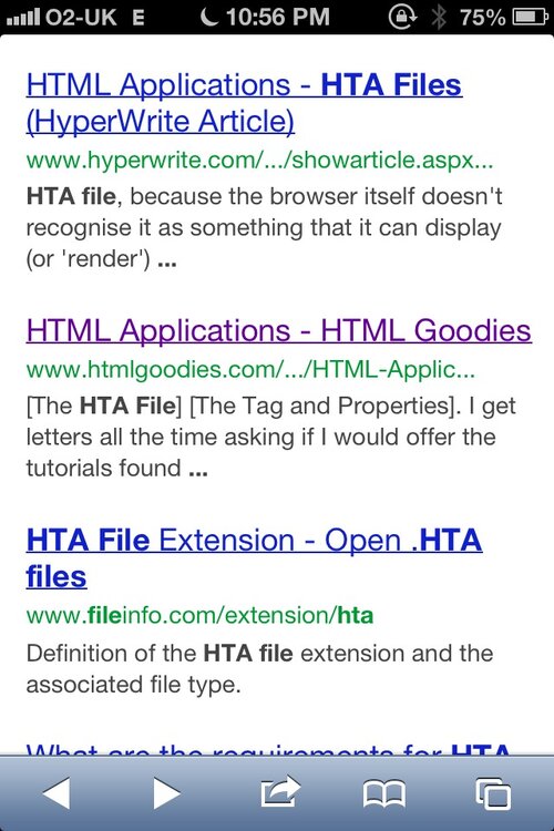

Don't thank me, thank Google. And my "Edge" Internet on my iPhone while on holiday. Slow but usable (just)
You found that on Google? I've been searching all day but not found anything. Ah well, thanks anyway and enjoy your holiday
