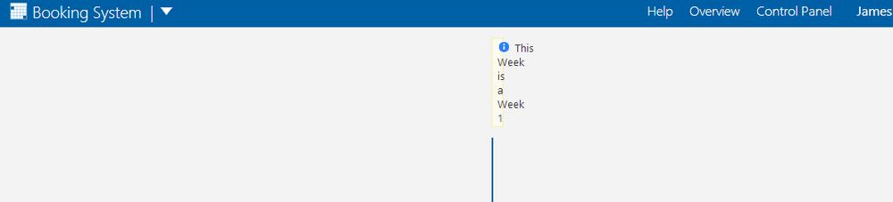

Also while everything worked first time the booking sheet on mine doens't appear to load properly, not entirely sure why though. I just get a blue line down the middle of the screen with "This week is week one" squashed up the top.

So this is what i get when i go to the api for one resource:
[{"Date":"01Monday 1","DisplayName":"Craig CA. Sargent","EquipRoom":null,"LTCount":0,"LTHeadPhones":false,"LTRoom":null,"Lesson":"AM Reg","Name":"10E","Room":"T8","Static":true,"Username":"sargentc"},{"Date":"22\/04\/2013","DisplayName":"Julie Brindle","EquipRoom":null,"LTCount":0,"LTHeadPhones":false,"LTRoom":null,"Lesson":"Period 1","Name":"Year 8 DT Res Mat","Room":"T8","Static":false,"Username":"protheroe"},{"Date":"01Monday 1","DisplayName":"Craig CA. Sargent","EquipRoom":null,"LTCount":0,"LTHeadPhones":false,"LTRoom":null,"Lesson":"Period 2","Name":"13D\/IT1","Room":"T8","Static":true,"Username":"sargentc"},{"Date":"01Monday 1","DisplayName":"Craig CA. Sargent","EquipRoom":null,"LTCount":0,"LTHeadPhones":false,"LTRoom":null,"Lesson":"Period 3","Name":"12A\/CM1","Room":"T8","Static":true,"Username":"sargentc"},{"Date":"01Monday 1","DisplayName":"Craig CA. Sargent","EquipRoom":null,"LTCount":0,"LTHeadPhones":false,"LTRoom":null,"Lesson":"Period 4","Name":"12A\/CM1","Room":"T8","Static":true,"Username":"sargentc"},{"Date":"01Monday 1","DisplayName":"Craig CA. Sargent","EquipRoom":null,"LTCount":0,"LTHeadPhones":false,"LTRoom":null,"Lesson":"Period 5","Name":"13B\/CM1","Room":"T8","Static":true,"Username":"sargentc"},{"Date":"01Monday 1","DisplayName":"Craig CA. Sargent","EquipRoom":null,"LTCount":0,"LTHeadPhones":false,"LTRoom":null,"Lesson":"Period 6","Name":"13B\/CM1","Room":"T8","Static":true,"Username":"sargentc"},{"Date":"01\/01\/0001","DisplayName":"Not Booked","EquipRoom":null,"LTCount":0,"LTHeadPhones":false,"LTRoom":null,"Lesson":"After School","Name":"FREE","Room":"T8","Static":false,"Username":"Not Booked"}]
Attached is what i see...
EDIT: connecting to localhost works ok, connecting to schoolwebsite.net/hap/bookingsystem loads it incorrectly.
EDIT2: control panel works fine though, it's literally just the booking sheet.
EDIT3: i can also use the overview to search for a specific user and bring up their classes.

Try a CTRL+F5, to clear the cache
Tried that, also tried restarting both the site and the app pool on IIS while clutching at straws.
What two outputs are you after?
It looks to be CSS related, can you browse to /hap/style/bookingsystem.css and compare it to the actual file, see if they match.
hmm without knowing what's changed the only thing i can pick up on straight away is the last line...
Loading the file on the server shows: "#datepicker .ui-datepicker { border-top: 0; }" at the end of the file, but browsing to that file doens't show that line
EDIT: ah they definitely seem different
Edited by mrbios
odd, it's getting cached somewhere along the line, and HAP+ doesn't cache files
hmmmm, well in that case i might just leave it until the morning, you never know it might clear itself given a bit of sleep :p
EDIT: ahhhhh that did it, restarted my ISA server.....3 more months then i can delete that thing from existance. CAN'T WAIT!
