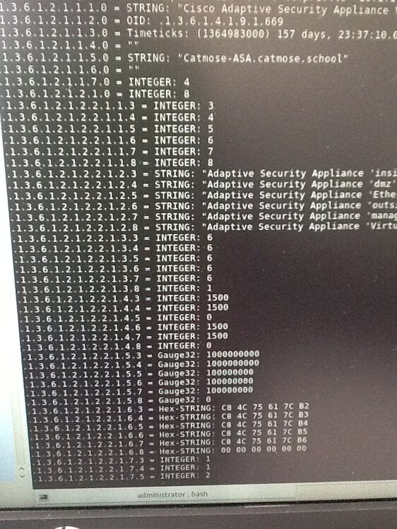

Managed to get back to doing some of this today - I've got a little further, seems i was missing some things - sudo apt-get install snmp-mibs-downloader<- by getting these and restarting Nagios i have gotten further. I'll post a image up in a moment
As you can see this has fixed the Uptime issues - which were red before and the error code for the ports has changed to "External command error: Error in packet"
Any thoughts?

MRTG is a separate package that gathers traffic and other stats that accumulate over time. Looks like the check_mtrggraf is trying to access those statistics so you will need to install and configure mrtg if you want to use that.
The fact that uptime is working shows nagios is talking to your switches. I guess the mibs package translates the 0.1.2.1 type notation to the more human friendly iOperUpTime notations. You could configure the call to return info from the correct trap with check_snmp but you will only get accumulated figure which without any context is pretty useless.
