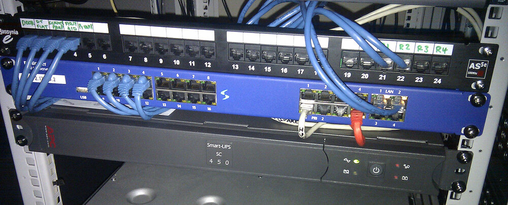

Couple of photos below:

I've added a couple of photos to the post. Hope it helps.
