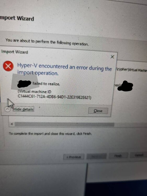

  21. Hi, Here is the error message attached
  22. Hi all, Hope you are well. I am moving our print server across to a new host by exporting and importing the VM. When I do this, I get the following error message- Hyper v encountered an error during the import operation Server failed to realise virtual machine id This error message occurs hours after the importing the VM in Hyper v has started Any ideas in how to overcome this error, please?
