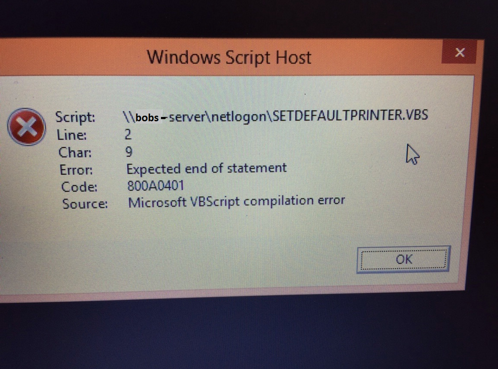

Personal Information

  3. Hi, I've attached what was working and what i require to work.. I'm seeing other info out there mentioning that we do not need the ""'s around the remove line. 1. Can anyone advise if this is the case? 2. If the script error-ed out, would it continue because of the "ON ERROR RESUME NEXT" line? Thanks in advance and sorry for the delayed replies..

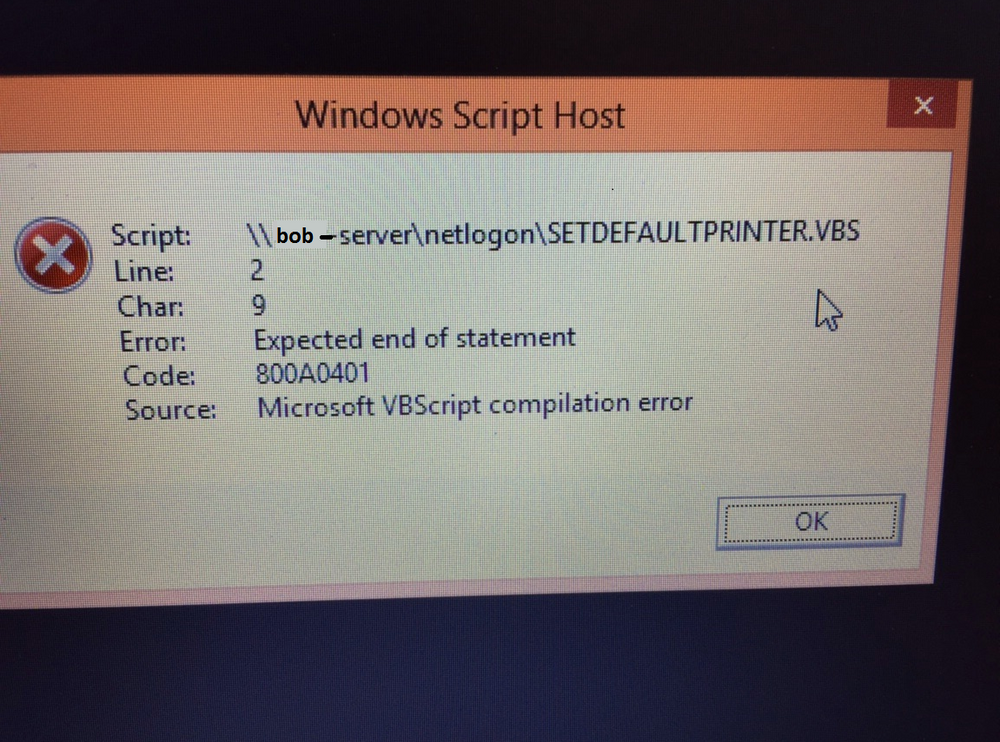

  4. Hi, the error message is below:
