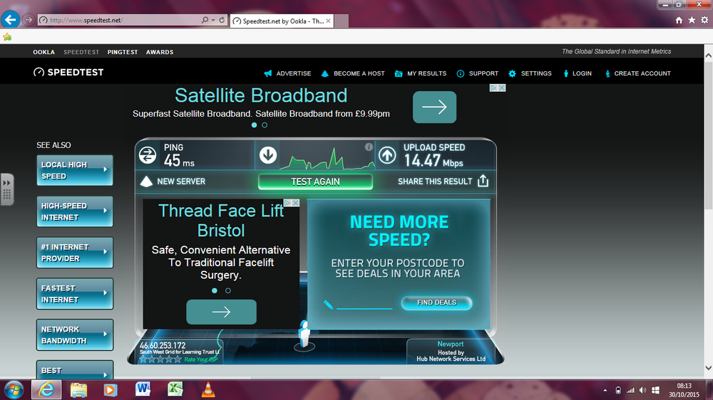

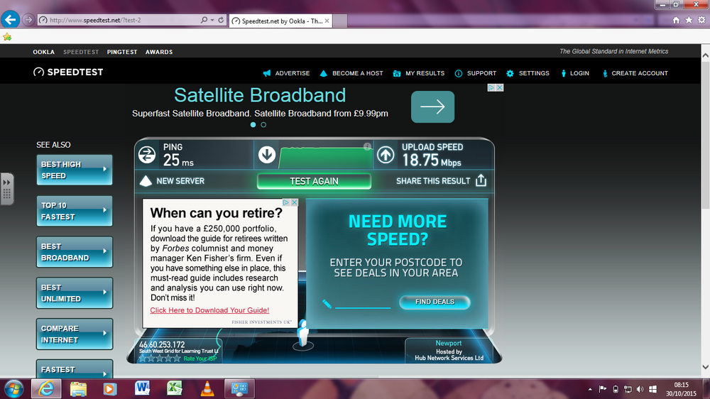

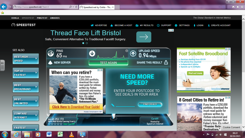

  8. Okay, so here are my finding now I'm back on site and have brought my UniFi Pro access point from home. Hope you can see the images! Just realised you can't see the speed:- with HP Wi-Fi the download speed was around 7Mbps, Lan 20Mbps, and UniFi around 9Mbps. Weird!
