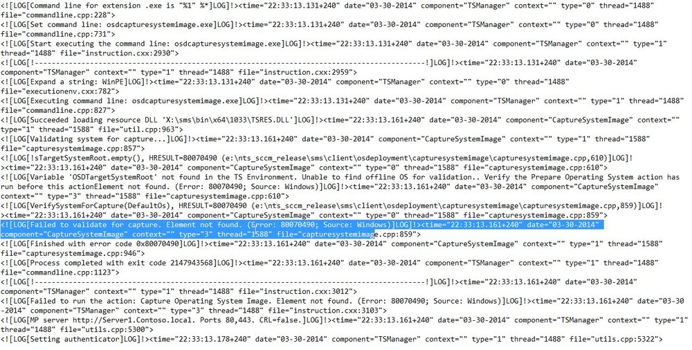

  1. I've attached the smsts log. - - - Updated - - - I've attached the smsts log. I was thinking maybe this won't work because a WIM file doesn't exist?

  3. Nope. I have Command support enabled. F8. I'm able to browse the x drive. The Task Sequence seems to fail instantly hence not generating a smstslog file. I can see Windows, Program Files etc. on the x-drive. I think it's failing because it can't seem to find the OS? I found the following link and tried what was posted in the link but no luck. ConfigMgr: You Receive Error 0×80070490 in a Capture Task Sequence | Trevor Sullivan's Tech Room Do you know the correct procedure on how to capture a master image via SCCM 2012. Maybe I'm doing it all wrong. I deployed the image. I created a new task sequence more than once. I don't seem to be making any progress. Brian
