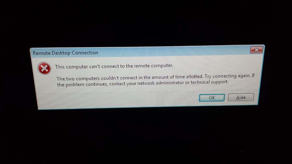

  7. right now i have gpo registry autologin with a domain common user (client.rdp) which autologons at boot and replaced explorer.exe with the script to open mstmc.exe in a loop. it works perfectly at boot and if i reconnect soon after terminal logoff but as i said, after a while, 10 to 15 minutes it does the error. is it possible to change that time allowed value on the server or disable it ? or is it better for me to change for the users to logon on the client with their credentials and autologin in rdp with the same credentials and do what you said, execute the script to close the client session after terminal logoff ?
  8. Hi, i have an error when i try to reconnect a session after about 10 to 15 minutes being idle: i click ok and then it works but i must get rid of this error, so how to solve it ? Got that error ScarfedOne ? thanks
