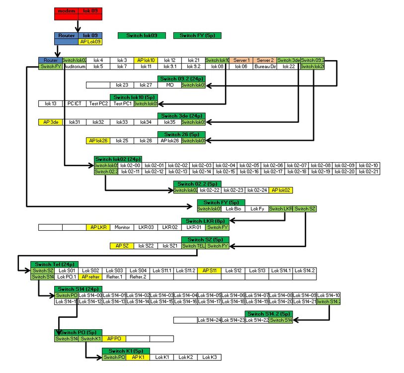

Guys I've searched the interweb for help on setting up a VLAN to separate our AP's from the network, so they only can use the internet but can not connect to our internal network. But it's still all a bit unclear for me. This is my situation: - Only 1 single link (port connected) between all the switches. - Only 1 subnet on the network: 192.168.1.x - 192.168.1.253: DHCP-server - 192.168.1.254: router - 192.168.1.248: main switch: DLINK DGS 1500-28 - Fixed IPadresses for all the other switches (DLINK easysmart family line) and AP's (cheap sitecom AP's) The ports indicated are used to connect the devices with eachother. With my setup: is it even possible what I am trying to do? does my AP have to support VLAN or can i just isolate the port going from the smart switch to the AP? If yes: Is it enough to create 1 additional VLAN on each of the switches (02 Wifi), there is allready a default one (1) with alle the ports untagged on each switch. What is the status of the ports (tagged/untagged/not member) on the 02 Wifi VLAN on the main switch? => I think its P4 tagged, the rest untagged? What is the status of the ports (tagged/untagged/not member) on the 02 Wifi VLAN on the second switch DGS 1100-8? => I think its P1 and P8 tagged, the rest untagged or also P2 tagged? What is the status of the ports (tagged/untagged/not member) on the 02 Wifi VLAN on the third switch DGS 1100-8? =>I think its P1 and P8 tagged, the rest untagged? Do I have to also tag the port of the DHCP server or router in the 02 Wifi VLAN on the main switch? thx in advance

the problem returned today, i again changed the password and the settings... solved again, but for how long? my switch: DGS-1500-28: 28-Port Gigabit SmartPro Switch including 4 SFP ports (fanless) from DLINK Can i get the info with that switch even if the device isnt directly connected to it but through a couple of other regular switches? -
