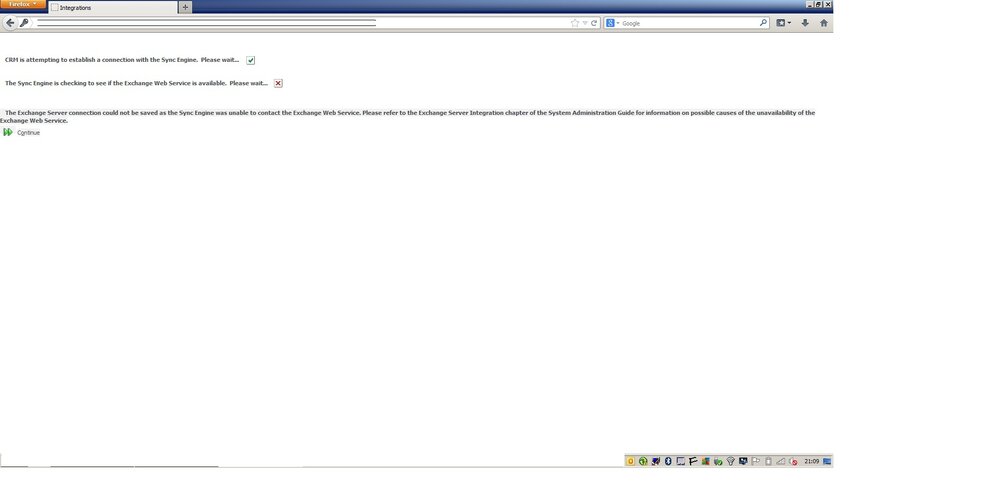

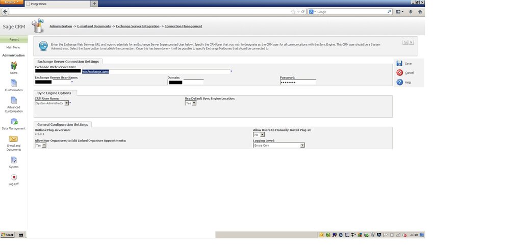

  2. Hi FN-GM, Thanks for your input, just out of interest why would a switch in between the router and firewall make any difference?
