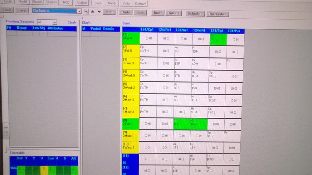

  2. Hi, Once the timetable is in progress is it possible to add in break and lunch duties. We currently just have the teaching periods on SIMs. J

  4. Gave this ago, but it seems insistent on displacing other lessons, this time a group of yr10 lessons! The newly assigned post 16 lesson went yellow so no green appears. The post 16 block then looks fine. It's only when you flick through the blocks for other years that I can spot anything dodgy and that's a Year 10 option block which has now gone blue and the timetabled slot dispersed. It just doesn't seem to want to clash! Is there a setting somewhere that is incorrect, or do I need to lock the year 10 lessons in first?

  6. So I need to drag it to the place on the timetable still and then that screen should appear? Many thanks for your help.
