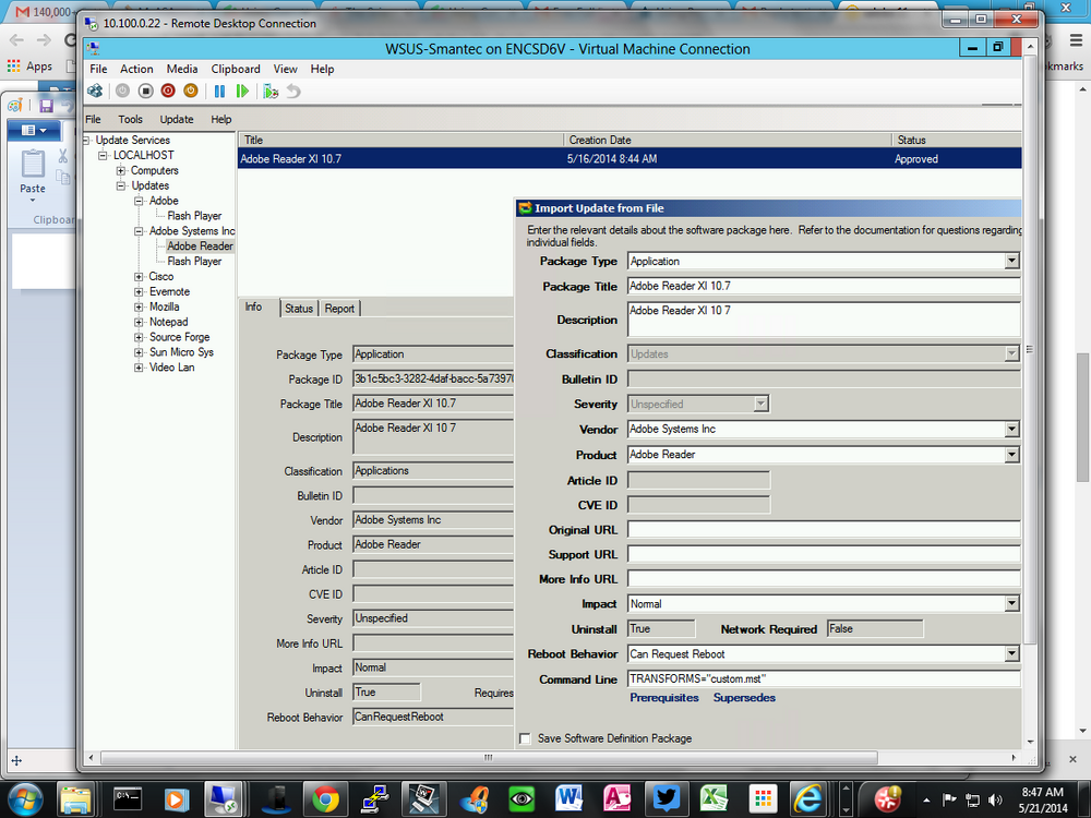

  1. Only takes a few seconds. I customize with customization utility. Here is a screenshot of the update I created within LUP. Also, I have tried deploying with PDQ but same it continues to display 11.0.0.0. Have not had a chance this week to test. If I download the latest adobe reader exe., it should have version 10.0.0.7?
  2. I push everything with Local update publisher. Sometimes for testing I use PDQ. I tried pushing with PDQ but workstation displays version 11.0.0.0. not 11.0.0.7.
  3. Trying to deploy 11.0.0.7. Current installation deployed is 11.0.0.0. Utilizing LUP, I download AdbeRdrUpd11007.msp from here Adobe - Adobe Reader : For Windows : Adobe Reader 11.0.07 update - All languages : Thank You, create a new LUP add AdbeRdrUpd11007.msp to files and run. Nothing get installed. Any help appreciated

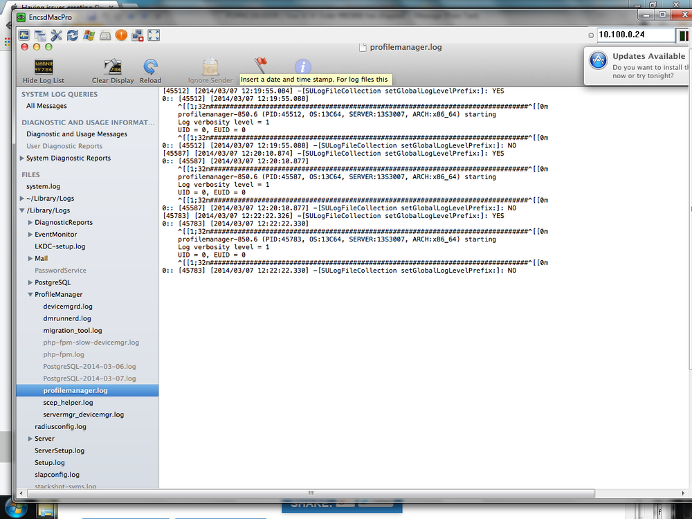

  4. When trying to connect to profile manager, I get the following error: "Website are turned off. An Administrator can turn them on using the Server application" Any help appreciated. Thanks
  5. Hey, thanks for the reply. I have apple enterprise support working with me on the issue. I and they have verified DNS is working properly and that I have profile manager setup correctly. I erased the hard drive and re-install os maverick previously still having issues. They are working with me to resolve it. I will post once complete. Thanks
  6. OS X Maverick, Have a macbook pro trying to install profile manager and getting error: Profile installation failed. the server "server.net" did not accept the certificate. I installed the trust profile no problem; however, I get error when trying to enroll. I compared a macbook that was installed but not getting anywhere. Which logs do I need view to troubleshoot this? thanks
  7. Profile manager is working. I was getting the 500 error because for some reason the diradmin appears not to have enough rights. Instead I logged in my user account which has admin rights. Device enrollment is working. Here are steps I completed to resolve the problem. * Created a boot flash drive to erase the hard drive. Great article: https://discussions.apple.com/message/23854384#23854384 * Re-installed Maverick * Followed these steps as recommended by seawolf. Using Profile Manager 3 In Mavericks Server | Krypted * DO NOT install as local if you are using DNS from a windows server * Open Profile Manager link and the login page opens, if you get the 500 error after logging in with user: diradmin , create a user with admin rights and login with this username A big thanks to Antonio and Seawolf!!!!
  8. I erased the hard drive, re-installed Maverick. Followed the steps from Using Profile Manager 3 In Mavericks Server | Krypted, click open profile manager, please login, username: diradmin, I enter password and get: "Sorry, something went wrong, we have been notified about this issue and will respond shortly". Please read profilemanager log to find out what went wrong.
