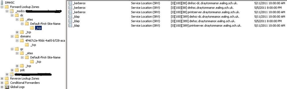

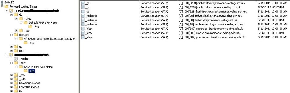

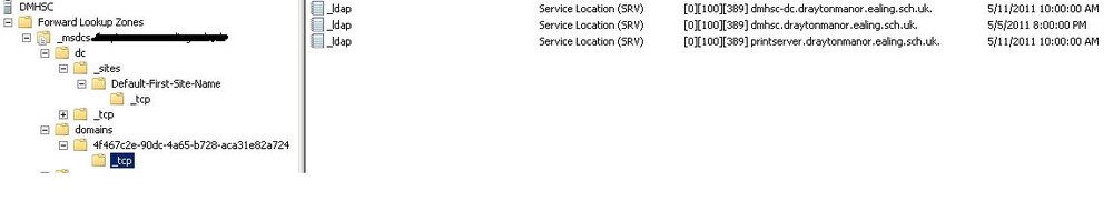

  1. Hi! Thank for the replay. I did have a look at ad sites & services and looks fine as each server points to another ones. I don`t have anything under subnets in ad sites & services. Regarding DNS only dmhsc is dns server as I have only one. All other servers have it`s ip under tcp/ip settings so they know it`s a dns server. I`m gonna have a look at the link you provided- thanks.
  2. Hi guys! Im writing here as I have few problems with my dns configuration. Let me give u some details first. I do have two networks in my school. Admin network is fine and do not have any problems with the dns. On my curriculum network I have 3 dc`s: dmhsc (primary, pdc, master, 2008) dmhsc-dc (ad, 2008 R2) printserver (ad, printserver 2008 R2) On this network I have very slow logon times, especially on applying computer settings when it takes good 3-5 mins sometimes longer. Also very strange when I run gpupdate /force on client machines and than gpresult I see that computer settings were picked up from different server than user settings, ex computer settings from dmhsc-dc and user settings from printserver. This happens most of the times 90%. I have started to do some troubleshooting of my dc`s. When I run netshare all servers have correct permissions to sysvol, replication works fine as well. I did run dcdiag on all servers: dmhsc - passes everything dmhsc-dc - passes everything printserver - failed on Running enterprise tests on : draytonmanor.ealing.sch.uk Starting test: LocatorCheck Error: The server returned by DsGetDcName() did not match DsListRoles() for the PDC. Netdiag dmhsc - passed everything netdom query /domain:mydomain fsmo dmhsc - passed everything, pointed everything to dmhsc dmhsc-dc - passed everything, pointed everything to dmhsc printserver - passed everything, pointed everything to dmhsc I did look at my dns on dmhsc and I don`t think it looks right. Insted of having only dmhsc under first site domain I have all of my dc`s. I have attached screenshots and would be very greatful if you could have a look. On my dmhsc I also get loads of security-kerberos event id 4 errors in event log. I also got quiet lots of dns-server-service event id 4013 errors in event log under dns. I did try to follow the guide hxxp://sgwindowsgroup.org/blogs/panda/archive/2010/03/19/client-going-to-different-domain-controller-randomly-for-authentications-cause-and-solution.aspx and deleted other servers but they came back at the same place after a while. Thanks for any help in advance guys!
