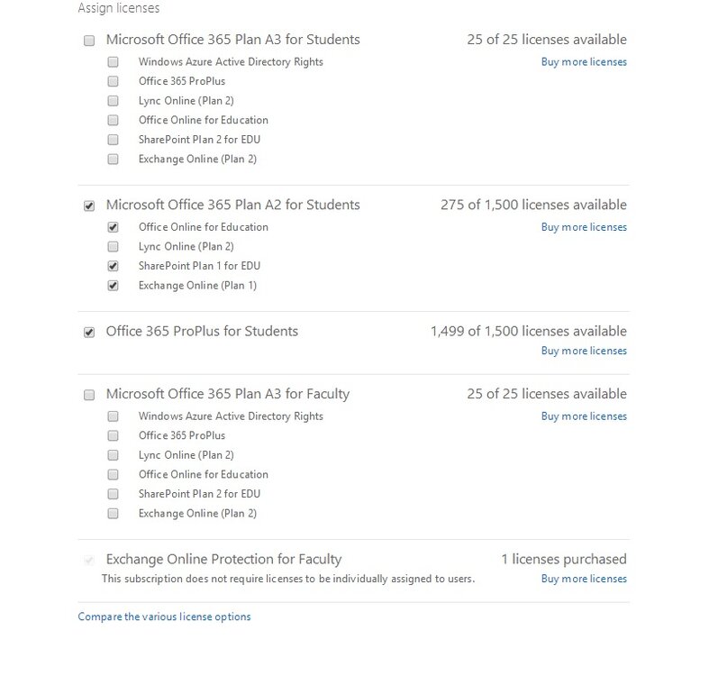

Hey Guys We have signed up for Office 365 and have got the emails set up, and ProPlus so the students can install office at home. Before we release it we want to get the OneDrive working, but this does not seem to work (I thought it would be default). I am not sure if Sharepoint is required for OneDrive. If I click on the OneDrive or sharepoint link it loops to the "Getting Started - refresh in a minute" page. It never goes further. Looking at the sharepoint settings users are allowed to create sites, however it does not seem to let them! I have seen a lot about Sharepoint Designer 2013 Hybrid integration but I dont really want to install it for one feature! I would be grateful for some help or a walkthrough that might help. Thanks T
