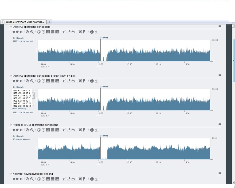

  8. An update to this problem. After a force panic of the S7210 the problem did not re-appear again.

  11. Hi Teejay, I am on the most current release of the software and I have already open a call with Sun. But it is taken them sometime to get back with an answer, that is why I have put this on the forum to get some feedback from other users of the S7000. We have got four test server connected to the S7210 and they all see this pause in I/O from the S7210.
  12. I am running continuous vdbench I/O from four servers (2 x Ubuntu, Windows2003 and OpenSolaris). Every now and again the S7210 CPU, network, ISCSI, NFS, CIFS traffic will pause this can be seen from the analytics. The pause in traffic can be up to 3 minutes long. Is this normal for this box? Please attached jpeg
