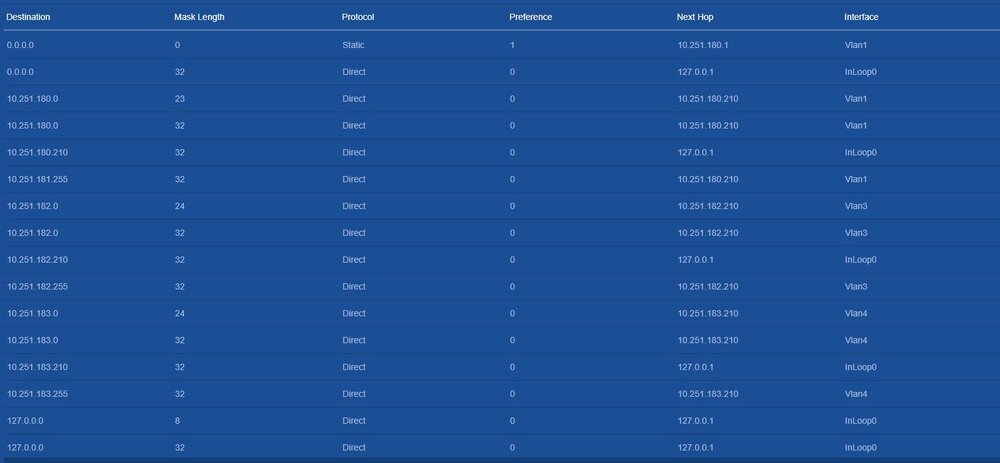

  6. Unfortunately this is the switch and what i have to work with. I cannot find anything in the GUI relating to RIP configuration ( probably has to be done through CLI) but it does appear in the statistics as per attachment. We do have a proper router/firewall from our ISP ( LGfL) I should mention that the switch logs don't contain any error messages, however it does continuously report that the "maximum number of ARP entries on the device has been reached". Is this something i should look into. It only appears as an informational log entry. Maximum number of ARP entries on the device is reached.Maximum number of ARP entries on the device is reached.maximumMaximum number of ARP entries on the device is reached.

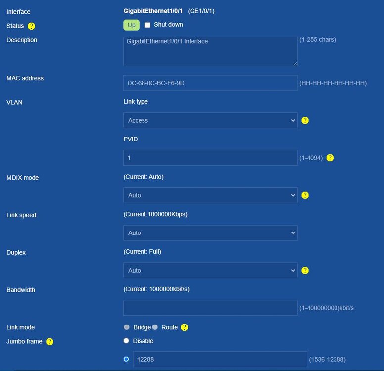

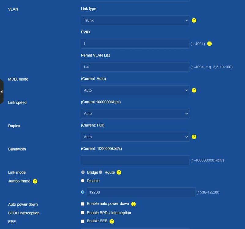

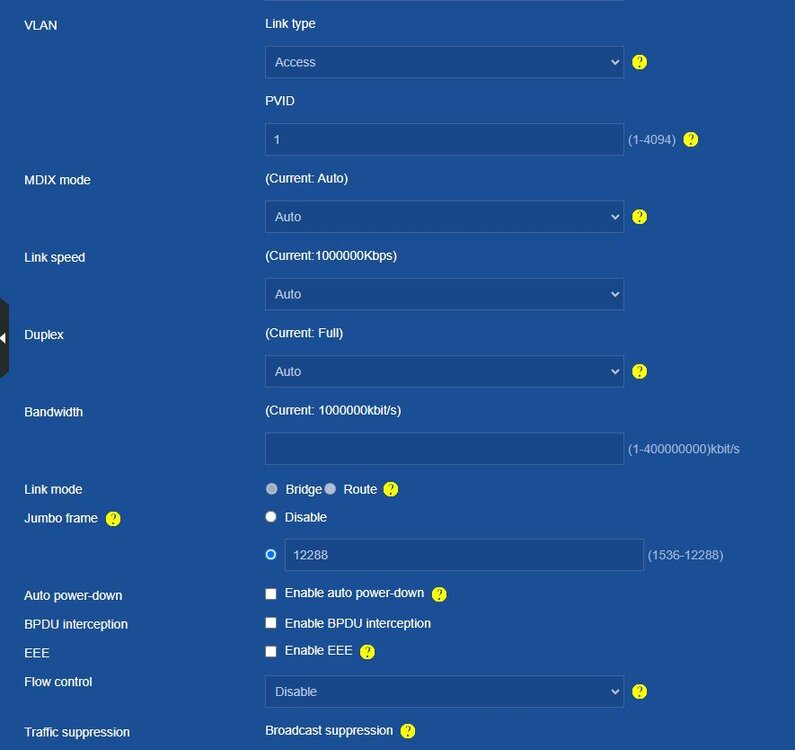

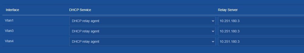

  7. I have attached images of the switch config relating to routing and IP helper just to confirm this is correct. I cannot see any ACL config enabled. The DC is on VLAN 1 which is the same vlan as the affected desktops but different to affected phones ( vlan 3) The output of ipconfig /all on devices on different vlans appear the same apart from the gateway entry which differs as each vlan has its own gateway IP which routes back to the core and obviously the device IP. STP is enabled MSTP. I need to look into where to find when it was last recalculated.
