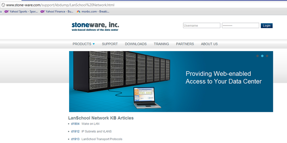

Just registered to this forum when I noticed my google alert went off with your question. As I'm New they won't let me post URL's, so here is an image of where you should go to check out some documentation that could help on your issues with LanSchool. Capture.PNG
Specifically take a look at the second on "transport protocols & IP Subnets with VLAN's"
Hope this helps
Just registered to this forum when I noticed my google alert went off with your question. As I'm New they won't let me post URL's, so here is an image of where you should go to check out some documentation that could help on your issues with LanSchool. [ATTACH=CONFIG]13501[/ATTACH]
Hope this helps
Thanks for the post. I have not looked into this as yet will have a look at it soon. It looks complicated so i am not sure i will do it to be honest.
I will look though. Thanks
