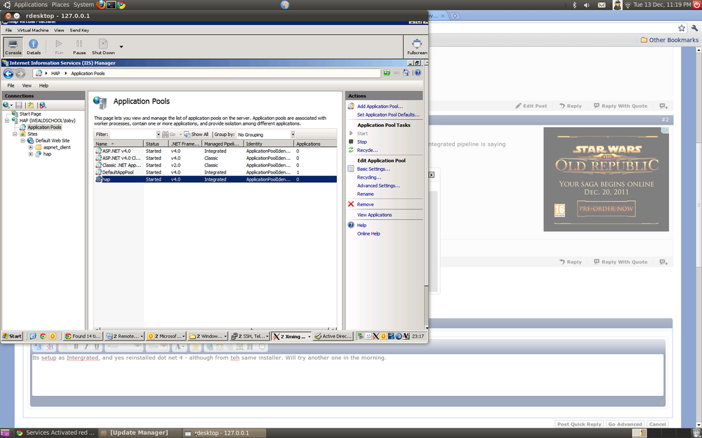

In IIS you need to make sure the HAP+ apppool is running in integrated pipeline mode, which the red x next to integrated pipeline is saying
Its setup as Intergrated and IIS is set to use the HAP application pool, and yes reinstalled dot net 4 - although from teh same installer. Will try another one in the morning - how do you restore defaults from it? i only get repair/remove options?

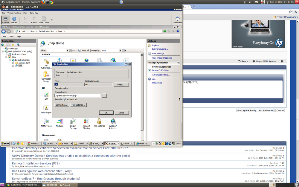

You have the HAP App Pool, but you don't have the HAP Application assigned to use it. Check the HAP Basic Properties
Ah wrong screen shot! Even with it assigned it doesn't seem to respond
Have reinstalled .net 4 from the web, I've also created a new application pool and tried to remove the app from IIS and recreate but i still get an error as in the first screenshots.
