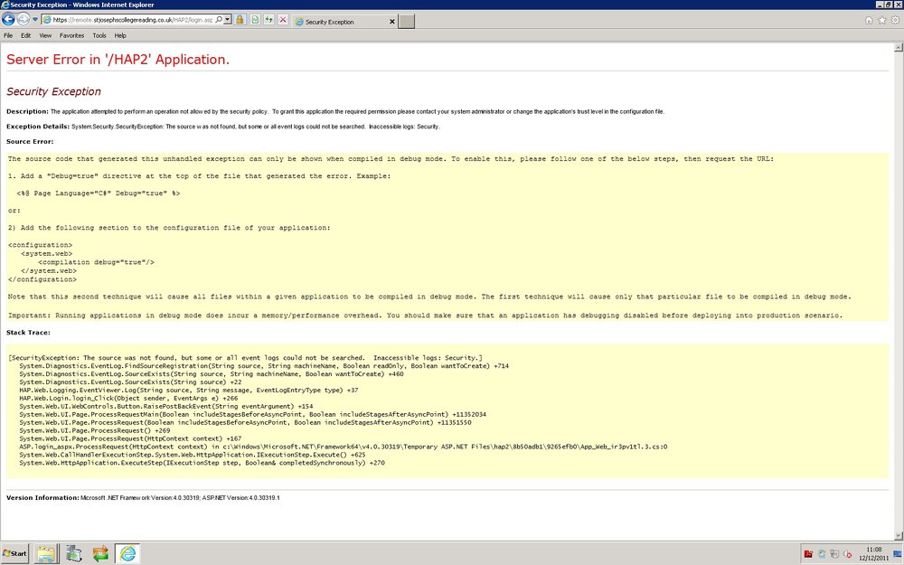

enjay Posted December 12, 2011 Posted December 12, 2011 I'm getting the attached error message on my test copy of HAP when upgrading to 7.8 Also, if this helps, the logon screen doesn't have any formatting on it. Any ideas?
nickbro Posted December 12, 2011 Posted December 12, 2011 Can you run the HAP+ Event Log Setup Program from the codeplex site on your server. It will create the HAP+ Event Viewer Log on your system
enjay Posted December 12, 2011 Author Posted December 12, 2011 Done. I don't see where it put the log file once I created it, though...
enjay Posted December 12, 2011 Author Posted December 12, 2011 That's fairly sensible! Oddly, everything is now fine again. I had the unformatted logon box, logged in, everything worked and on logging out got the normal logon box. It did this last time I did an upgrade too - is there anything which needs to replicate anywhere or something like that?
nickbro Posted December 12, 2011 Posted December 12, 2011 If it's unformatted, it's may be having an issue loading the style sheets up
