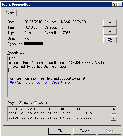

This is the eventvwr error on the server :
[17113 :
initconfig: Error 2(error not found) opening 'C:\MSDEMSSQL\Data\master.mdf' for configuration information.]

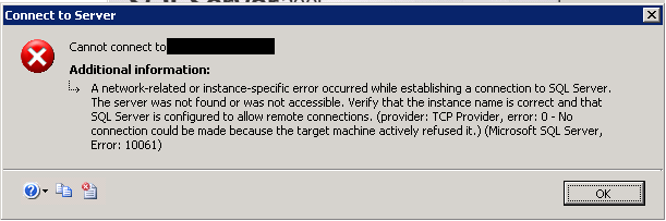

and there's an error that occurs when trying to connect to the database instance from another server (screenshot)
It looks like it says it can't connect probably due to the server switching

Check your SQL config to make sure TCP/IP connections are allowed and also named pipes are enabled.

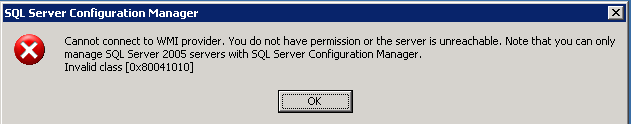

I'm having difficulty changing settings for the SQL installation on the server as Server Configuration won't open - Have attached another screenshot for this

Update:
read this SQL Server 2005 WMI Provider Error - Technical Weblog of Eric Charran - Site Home - MSDN Blogs and ran the command C:\Program Files\Microsoft SQL Server\90\Shared>mofcomp "C:\Program Files\Microsoft SQL Server\90\Shared\sqlmgmproviderxpsp2up.mof" as suggested
this fixed the problem of being denied access to SQL Configuration Manager (NOTE: I had cd to the 'Shared' Directory then run the command minus the directory path) Hoorah!
