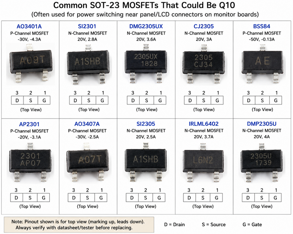

I'm glad that helped and I'm sure it made even more sense to you than me! I'd like to create a AI champion role at work, and be that person, because used appropriately there is a lot of value to be garnered - equally, used badly, you can waste quite a bit of time. When I researched I used Gemini and ChatGPT. ChatGPT built and image for me when I asked to visualise the components in question. Attached just because I can!
Caveat! AI and I can be wrong 🤯
