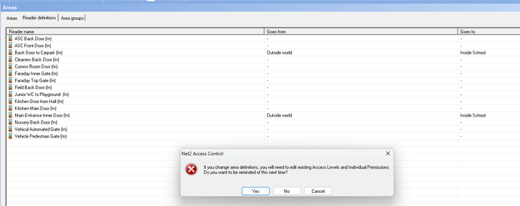

By the way, entire site is just 2 areas:
I assume all that needs to be done is copy the above settings for the Kitchen Main Door, right? Going from Outside World to Inside World.

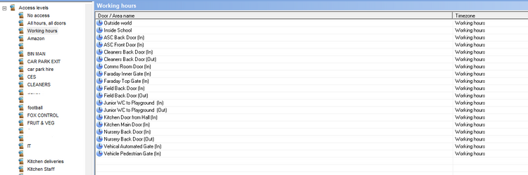

I'm a bit confused about the warning message though. There are no setting I can adjust to accommodate the above change?! The Timezone is just permitted hours and an Access Level has a specific Timezone assigned to each door. What am I missing here?
