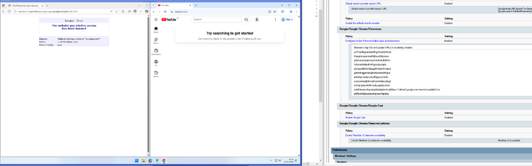

We have an issue with the Impero extension that is set to be pushed out to Chrome browsers yet it's not being deployed as expected. The same extension ID is working as expected with Edge browsers.
We are currently a mix of v141 / v142 of Chrome browser yet neither seem to want to install the working version of the Impero extension. The MV3 Impero extension for chromebooks deploys to Chrome browser.
We are trying to deploy out extension id: pdmhilamamchgnnipghbjakjpbenbcdj;https://clients2.google.com/service/update2/crx
Has anyone else experienced this issue?
Attached is a picture of the issue.

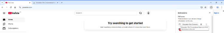

I've got that to deploy out but for some reason it's not working or enabling, instead it's greyed out.
Might you need to remove the old extension beforehand? (block it via GPO)
I just checked our GPO to see what we did, and realised I haven't even pushed this extension out to anything except our Chromebooks! Makes sense why every blocked page closes the whole browser window now as it's just relying on the client app. I'll push this to a few windows devices and see how it behaves and report back.
Example of the MV3 being deployed but greyed out in the image.
Group policy is set not to deploy pdmhilamamchgnnipghbjakjpbenbcdj;https://clients2.google.com/service/update2/crx which is the MV2 version of Impero and lpkffpnklfdjompeeodhpaeenfdpibmj which is the MV3 version. This is also set on Google Workspace.

MV3 is working fine on our Chromebooks but I get the same as you on the Windows devices (on Chrome at least). Edge works fine! Digging further into it now though.
