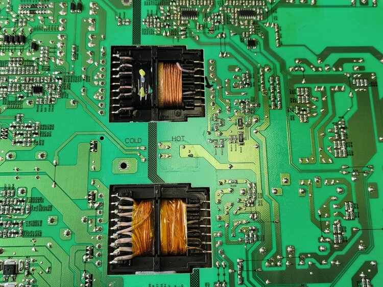

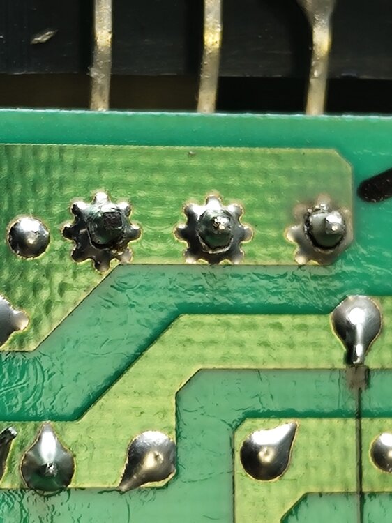

synaesthesia Posted April 13 Report Posted April 13 Necro thread time! @Aprice do you recall if those failures resulted in what looked like backlight issues or was it just a dead no-power situ? Just got an AP7-70 flashing at power on with a very audible sparking. Already organised to swap it out with an older board to get them up and running, but if there's a chance it's power supply I'll be able to fix that for pennies, unlike the backlight
synaesthesia Posted April 14 Report Posted April 14 Just in case anyone gets similar, I found the source of the problem. Extremely poor soldering and lovely dry joints Well worth a check if you're frugal/tight/broke. Back off, disconnect everything, make sure you discharge the caps (row of 3 on these). Fresh flux, lovely leaded solder and it'll be good to go again. Does indeed present like backlights on their way out but the sparking suggested otherwise, and the slight scorchmarks on the protective black plastic covering behind the PSU pinpointed the spots 1 1
