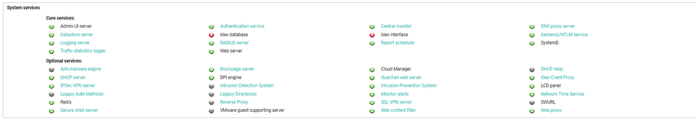

Come into work this morning and the idex database on the smoothwall has an internal error. Was working fine yesterday.
No one able to get out to the net, anyone able to help?
Only work around is to put every through a no auth rule and give network admin rules.

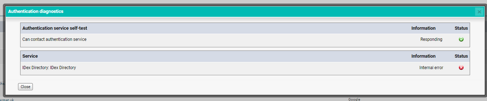

When i try to re-create an idex directory i get:
"Internal error: Could not update IDex cluster configuration: Could not reload authd5"

When i try to add a new Idex directory lookup i get

I disabled the Idex directory. I've cleared the Idex Store / database from the Settings menu but when i go to enable the Idex directory i get - Error: Internal error: Could not update IDex cluster configuration: Could not reload authd5
