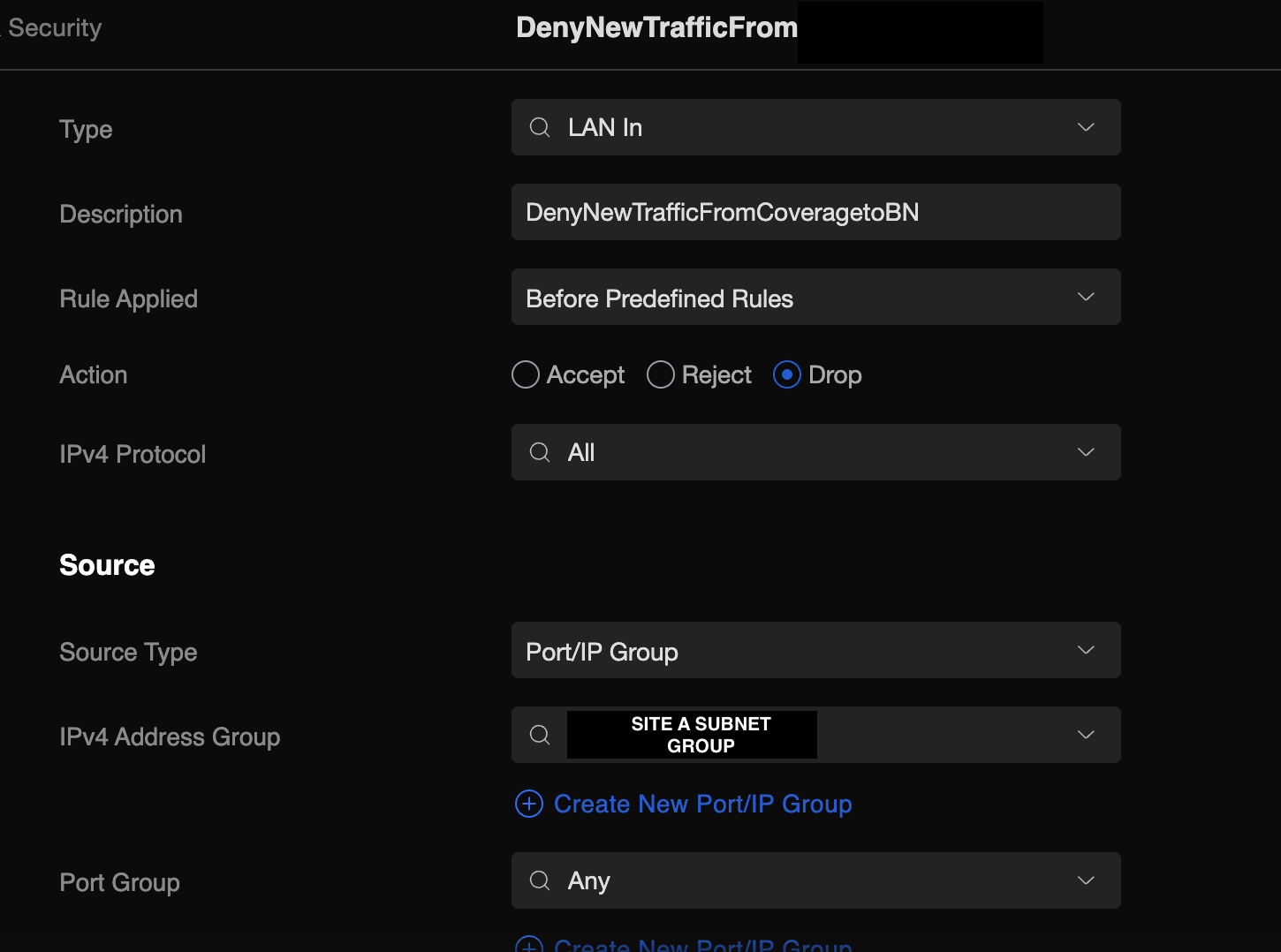

Hoping you can help as I'm really unsure what I'm doing here. I have two sites with the following IP ranges:
Site A: 192.196.91.0/24 Site B: 192.168.200.0/24
I want site B to be able to ping site A but not the other way around. I also need the firewall rule controlling this to be on Site B's side of things.

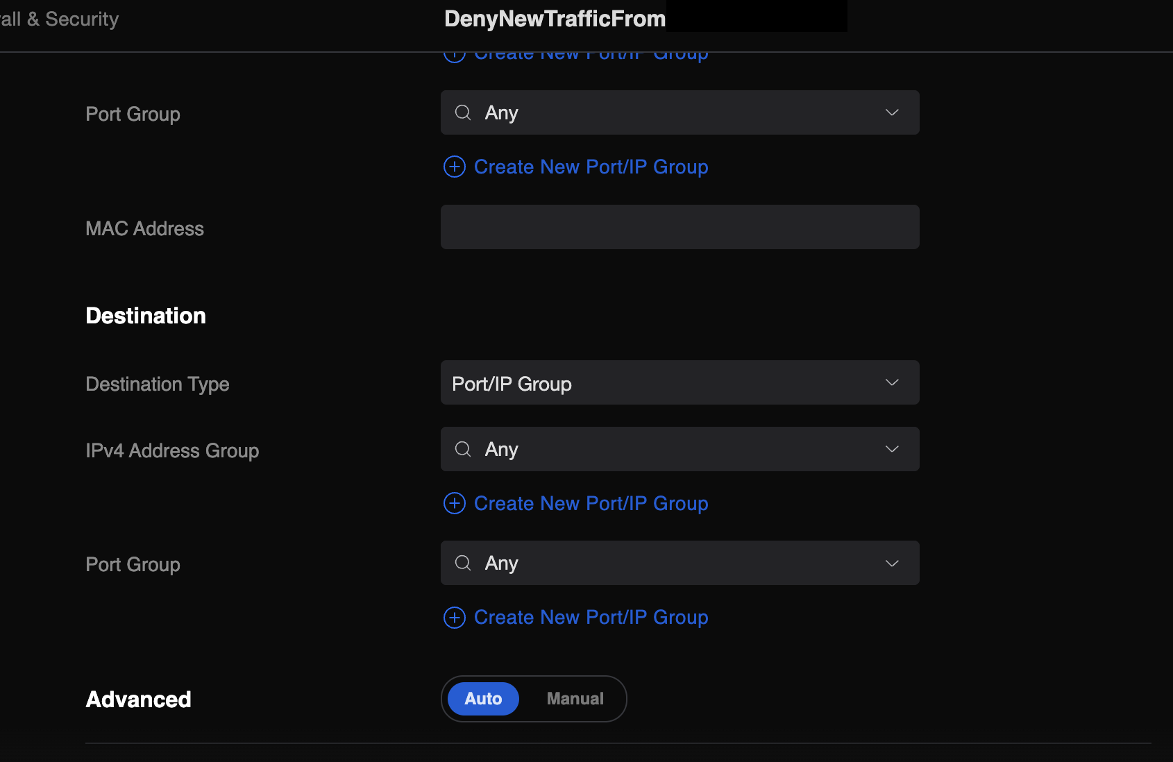

I've setup the following which I thought should work but I can still ping from site A to B? The IPv4 "Source" group has it selected as the 192.196.91.0/24 network and on the destination I've tried having it just set to Any network and have also manually added 192.168.200.0/24 but to no avail.
Any help from someone much more in the know than me would be most appreciated :)
[ATTACH=CONFIG]70029[/ATTACH]
[ATTACH=CONFIG]70030[/ATTACH]

If you are testing by pinging the firewall internal IP on A from B then you may get misleading results. Not a Unifi user but generally you would setup a policy to deny source IP range A access to Destination IP range B. This can be added on either side really. You may need to pay attention to the interfaces too - if traffic is passing over VPN, the VPN interface may need to be set specifically in some of these policies.
Thanks for your help, not doing that I'm pinging a seperate device on both networks to test.
I thought that's what I've done with the above rule to basically drop all source traffic from A to B?
I'm assuming that was in reference to the fact you have it set as "Lan In" rather than WAN/Internet etc, depending on what it's called on Unifi
If the second network isn't defined as a local/LAN one the pings would be coming in via the WAN/Internet interface normally. e.g. A client, goes ping, goes to A firewall, out via WAN/Internet interface, goes to B firewall in on WAN/internet interface and should be dropped there
