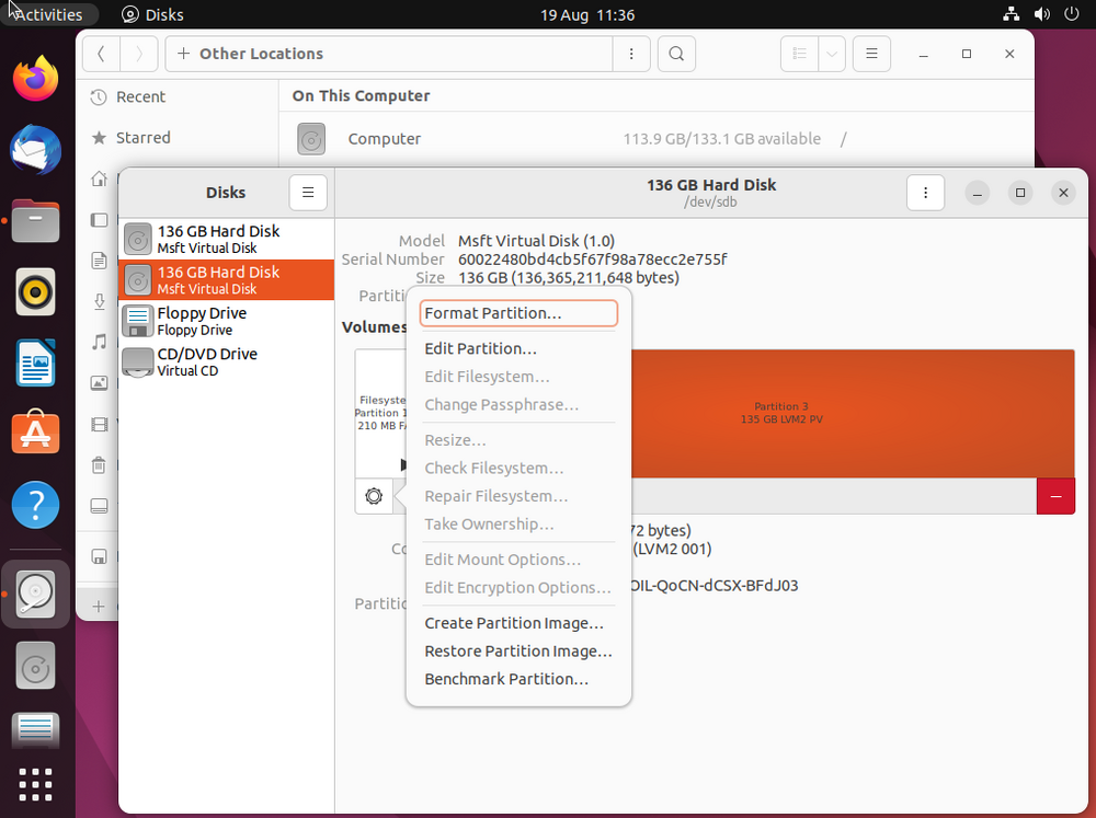

The Edit Mount Options is greyed out:
I assume you're working from a copy of the virtual disk so that you don't accidentally remove the partition.
You might just have to install LVM2 on the new VM then restart the VM to pick up the partition.
To install LVM2 on ubuntu, open a new terminal window and enter the command:
sudo apt install lvm2
You will have to enter a root password and confirm the install.
Otherwise there is a guide to mounting LVM2 partitions here:
https://www.cyberciti.biz/faq/linux-mount-an-lvm-volume-partition-command/
First issue sorted! After a reboot it automounted the LVM volume/partition/disk/whateverLinuxCallsIt so I can now get to the folders/files I need to make a copy of.
