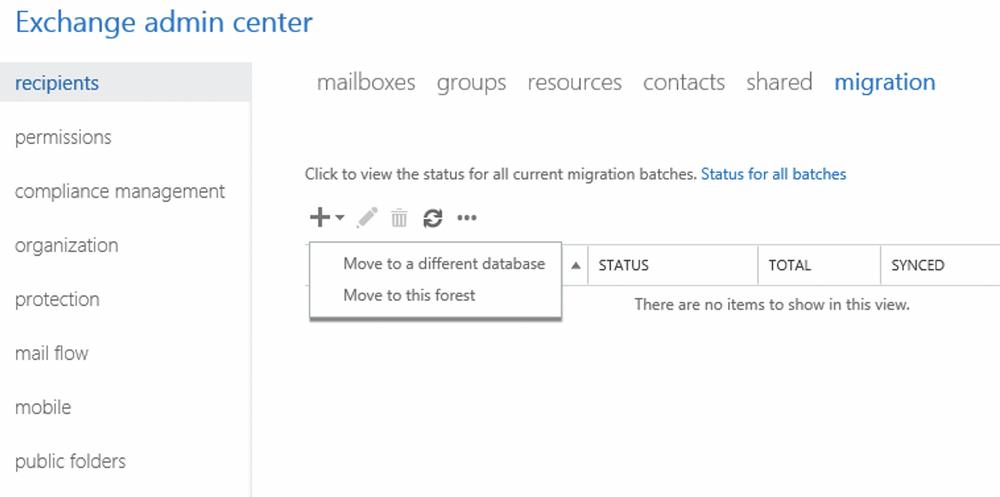

I was going through this guide, I've had a couple of set backs but got through each of them with a little more research and now I'm on point 3 which says go to recipients - migration - new - migrate to exchange online but I don't have that option on my exchange server?

Hey Everyone,
Hopefully one of you guys can help.
You need to do this part from the Office 365 exchange online portal. Hopefully you've set up the migration endpoint there, as you may need to do that too?

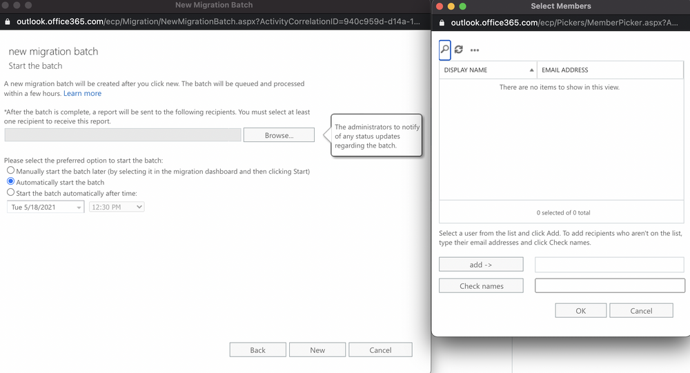

Thanks both :) That worked, it was me being an idiot and not reading the documentation properly. I have added the Migration Endpoint into Exchange Online.
The only issue I have now is that when I start an 'Migrate to Exchange Online' wizard, it all fills in properly and lets me get right to the end but then it asks to browse for a user to send a report to. I've clicked browse but no users are shown? Bit confused... Is there something stupid I'm missing again?
Thanks both [emoji4] That worked, it was me being an idiot and not reading the documentation properly. I have added the Migration Endpoint into Exchange Online.
[ATTACH=CONFIG]61844[/ATTACH]
Is the user account you’re trying to send the report to sync’d to 365?
You should also just be able to type an email address in the check name section I think
