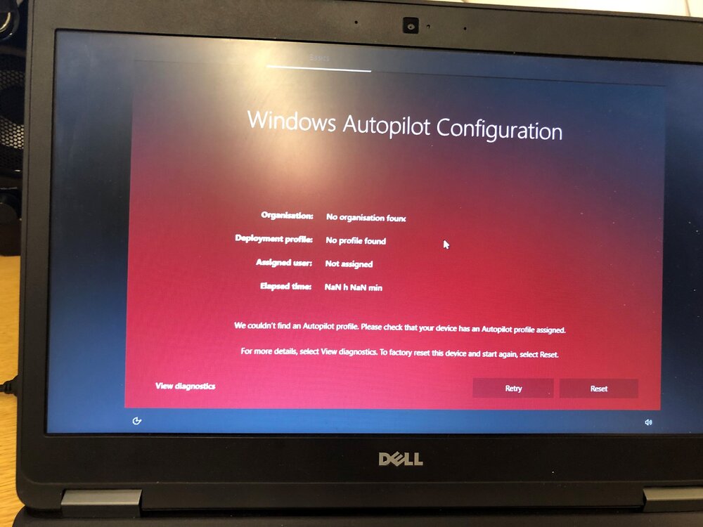

I have installed Windows and at the OOBE screen and used the powershell script that joins Autopilot. I have removed the assigned test user from the device and now when starting it asking for Microsoft Account information (with the option to join domain wich i dont want)
How do i get past this point?

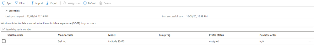

I’m working on the theory you have blanked out the serial and it’s not just showing as blank?
Yes - I blanked the Seral Number. Yes its showing there. But not in Devices.

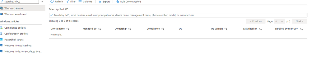

If you login to the test laptop with that test user does the device appear in devices rather/as well as Autopilot Devices?
Nope, Just showing the Autopilot not Devices...

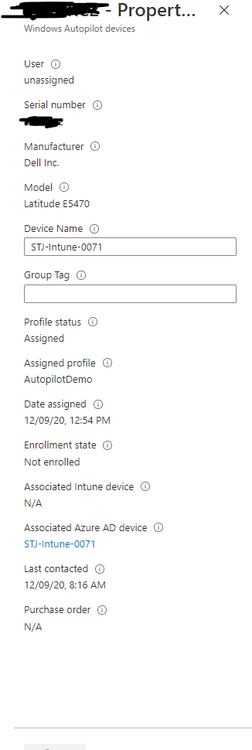

That's the one. By the looks of it it doesn't look like its finished/started its enrollment process (See "Enrollment State"). Ours show as "Enrollment state: Enrolled" and have a associated Intune device for comparison.
In the Azure Portal, under your org's Azure Active Directory, Devices and then Device Settings (This link may work: https://portal.azure.com/#blade/Microsoft_AAD_Devices/DevicesMenuBlade/DeviceSettings/menuId/) where it says "Users may join devices to Azure AD" which users are listed, is that test user one of them?
All is currently selected on that screen. May leave the laptop on for abit and see what happens.

From the looks of it your setup seems to be pretty much which we have running here on our test PCs. As you mentioned I'd give deleting every trace of it and re-adding it a go (with a reinstall of windows). If you aren't already try the latest version of Windows, I think they sometimes have AutoPilot improvements in the latest builds

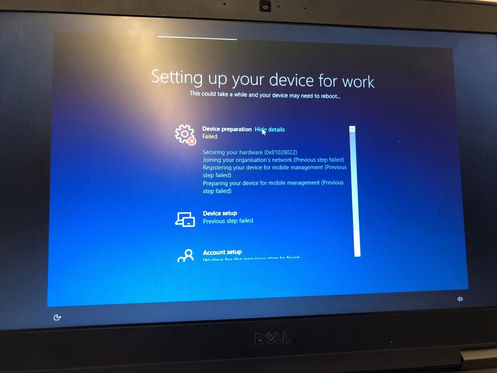

If I remember correctly you only need TPM 2 or above if you use White Glove deployment, user-driven deployment does not require this?
I have just updated the firmware for the TPM to 2 now.
Just trying again now..
You don't need TPM for autopilot (only white glove as mentioned above). I have several machines without TPM and they work fine when deployed via autopilot.
When it fails, hit Shift+F10, type
MDMDiagnosticsTool.exe -area Autopilot;TPM -cab c:\autopilot.cab
and grab the cab file. Some logs are best opened in CMTrace. There's descriptions of the various log files here
