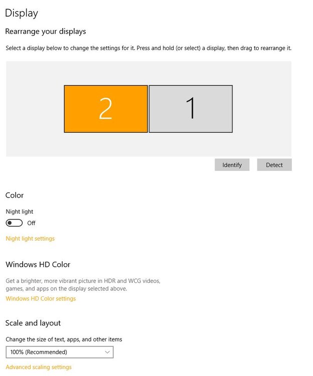

So it seems when you connect to a big touchscreen on my network (on extend) the DPI% changes to seperate values on each screen, so one screen can be 100%, the other 125%
This isn't a problem until someone starts using the pen tool on the touchscreen and it doesn't match the powerpoint.

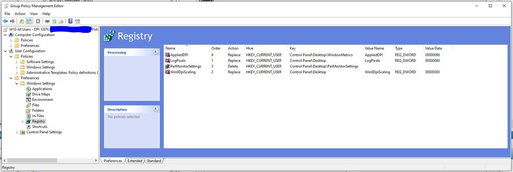

Or better yet does anyone know how to set the advanced DPI settings via GPO or registry?
The same thing does happen rarely on duplicate, but it's more consistent.

Though after testing for an hour or so I think I've cracked it, I needed to put a '1' not a '0' in Win8DpiScaling as this is what 'forces' windows to the 100% (96dpi) setting and greys out the option to change it.
Hopefully it hasn't broken anything!
