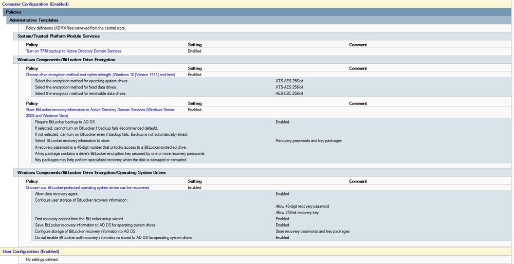

googlemad Posted November 27, 2019 Author Posted November 27, 2019 I finally got around to looking at this properly, do the attached Group Policy settings look vaguely correct? (I added the Recovery Key tab to AD and can see those going in which is good)
