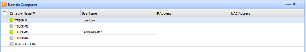

I just installed Skeep and I'm getting this error when trying to deploy:
TIME/DATE - COMPUTERNAME - computer is unreachable
Any help would be greatly appreciated!
Not seen this one before I don't think but normally if the computer is unreachable its got something to do with either the firewall/permissions/wrong ip of the machine or something. Is the time/date synced across the network? Can you access the C$ share on the machine and make changes?
I actually cannot access the computer from typing \\COMPUTERNAME or \\COMPUTERNAME\C$
Do you know what GPO I can get that fixed with? There just so many and I dont remember them all.
I would agree with Sted, if your a domain admin you should be ok with c$ test turning the firewall off on a PC and try it then
Nope...my bad, I typed the computer name wrong. It is working and I can browse the c$. I can create files, delete files and folders, etc.
To clarify, I can view the c$ folder, but I still get the error message.
I click deploy VNC and a CMD box pops up (says its ping.exe), nothing shows up. The box goes away and then I get the error.
I must be missing something? Any other diagnostics I can try? I have the firewall off on the destination computer and still have no luck.
Can you right click the client and successfully ping it? And is the IP Address column filled in with the correct IP? Just seems like the console isn't contacting the machine correctly

WOW blast from the past! Didn't think anyone would be even trying to use this anymore it was created a long long time ago. (See last post 2013) I can't really help much as I don't have it installed anymore and haven't used it for a long time. But I would say the script is looking for the FQDN and maybe its not finding the domain name, maybe something to do with DNS?
