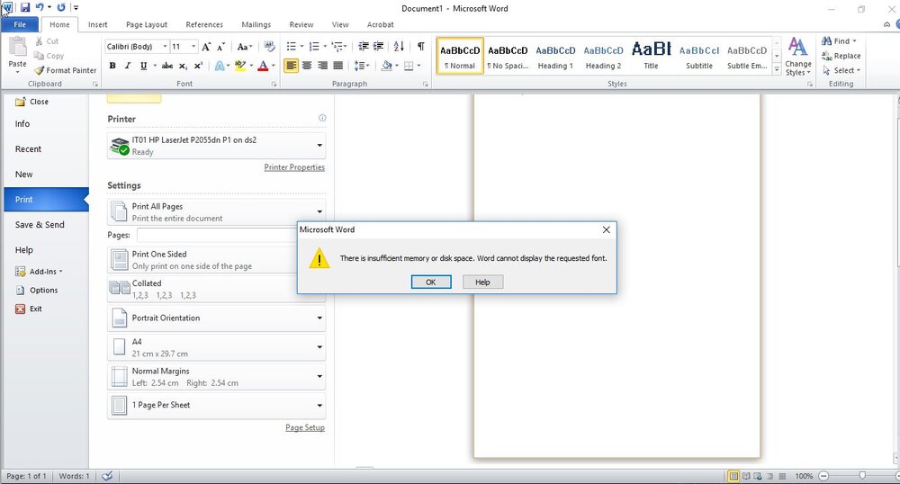

AJWhite1970 Posted November 9, 2018 Posted November 9, 2018 OK so this is driving me nuts. I've got a few Windows 10 1709 x64 PC's running Office 2010 x32 who can't print in Word but instead get the following error on screen All the other apps in the Office suite (powerpoint, excel, Outlook et al) all print fine, it's just word, even in safe mode so it's not a plug-in issue.... I've gone through eleventy billion web pages all suggesting fixes but nothing appears to cure it. Anyone got any suggestions or seen/fixed this themselves?
Patrick Posted November 9, 2018 Posted November 9, 2018 (edited) Had the same issue occur (with a slightly different wording on the error) with word not printing due to a "disk space issue". Never found out what causes it, I bounced the print server / rebooted the clients and it seemed to fix it for now. But no doubt it'll come back. I had the issue with 1709, office 2016 and Server 2016. Edited November 9, 2018 by Patrick 1
AJWhite1970 Posted November 9, 2018 Author Posted November 9, 2018 Already bounced most things including my head against a wall but apart from a headache, nothing was fixed. Windows 2016 print server (although does it with a local printer as well) 1
AJWhite1970 Posted November 9, 2018 Author Posted November 9, 2018 Looks like you might be right, just in-place upgraded one of the broken PC's to 1803 and suddenly it can print....
AJWhite1970 Posted November 12, 2018 Author Posted November 12, 2018 And indeed for anyone else who hits this cracker, it does indeed look like 1709 is the culprit as I've now inplace upgraded 10 of the worst PC's that had this error and all of them have started working again now they are running 1803. Fun times....
