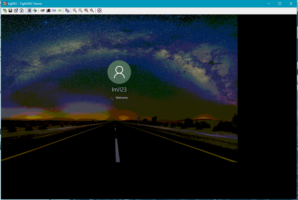

And to top things off, randomly, Tight VNC will totally freeze up when I log in as a user like this:
I am unable to do anything, if I close VNC and re-open, I am presented with a black screen.
Just seems to be problem after problem.
