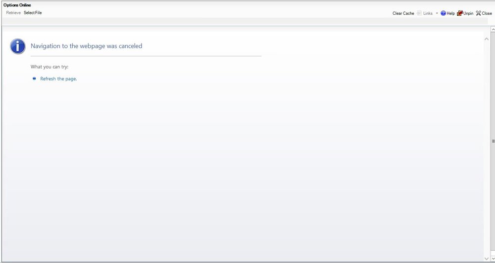

However when I come to access it within SIMS I get the following errors
Before I sign in
I am able to click on the top right corner to give me the login option
Logon screen with the different sign in options comes up ok, I select o365 and sign in and then get returned to the above image.

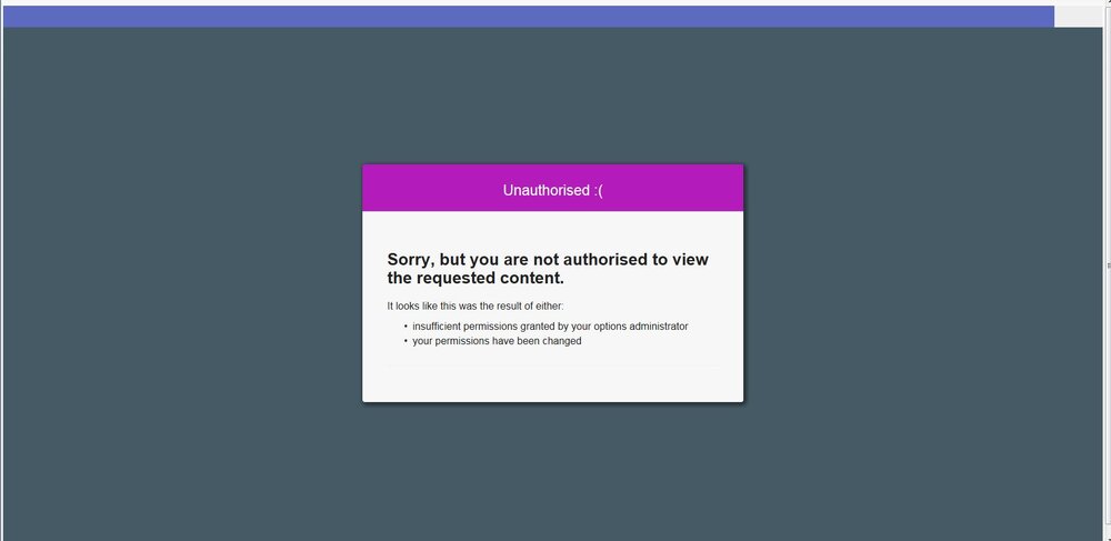

this is from a client side when i try it on the server i Don't even get this error message i get the following
But i am able to access it via IE from the server so no proxy based issue that scream out at me.
