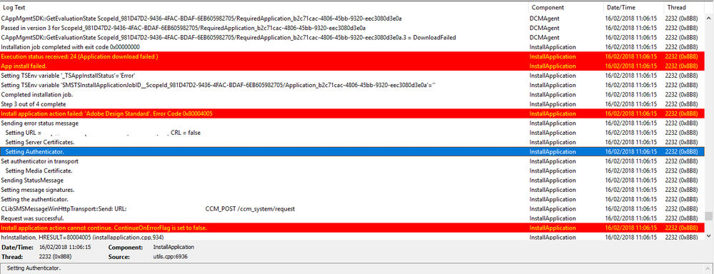

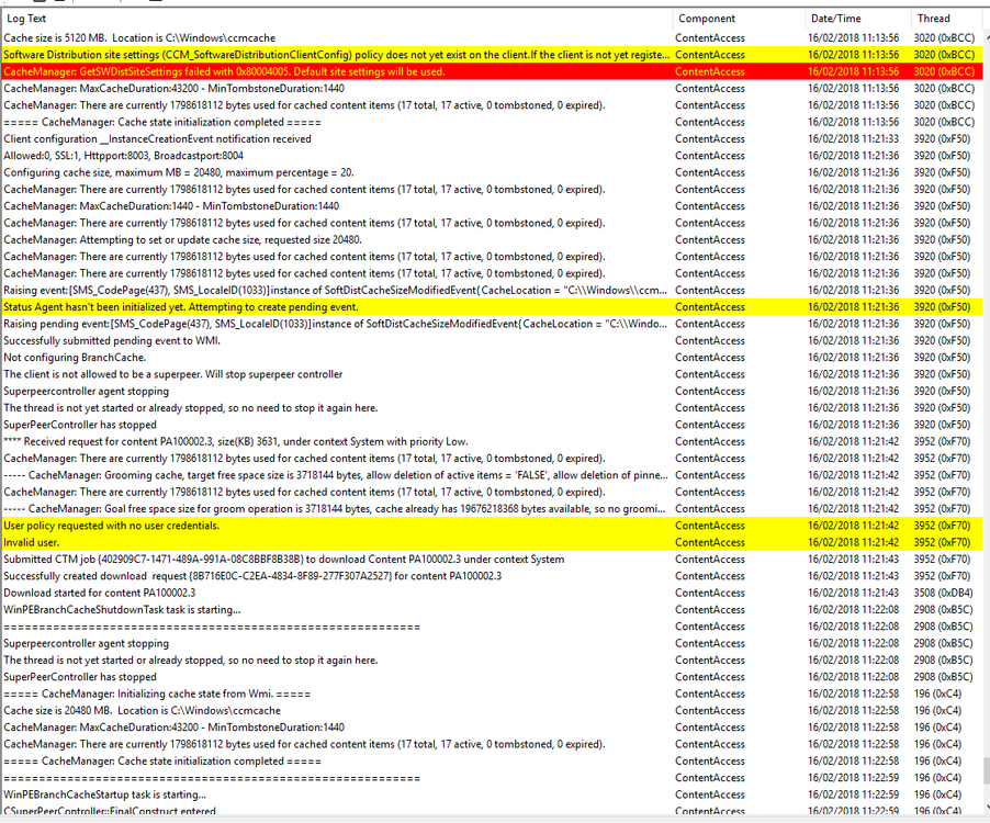

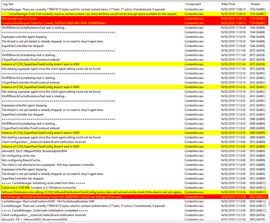

Ok am having another issue with an app further down, it appears the cache is full so wont download it. I did increase the cache size in client settings to 20GB but it doesn't seemed to have applied, as you can see in the log below it starts at its default of 5GB but then after the app has failed it then increases to 20GB, do you know why it isnt set from the start?
Tbh I think this was my problem before and is my only problem, the app is adobe design standard so is over 4.5gb itself which was why netbeans was working when it was installed above adobe.
You've been a great help so far Steve and really appreciate it but do you have any ideas?
Here are the logs as screenshots:
Where are you setting the increase? If you're doing as it part of a policy it won't apply until after windows finished as that's when it's pulling it down.
You need to do it as part of the command line install options on the configmgr package/push installs if you want it applied from the start
Steve
Steve
Right I was doing it from the client settings in config mgr, see below:
So I need to add it in to the task sequence before the app installs as a command line?
On your TS under the Setup Windows/Configmgr add in a line into the installation properties:
SMSCACHESIZE=10240 (10gb example as on mine)
Steve
