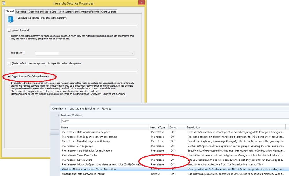

Steve21 Posted January 11, 2018 Posted January 11, 2018 It's only in pre release if you want it now you need to turn on pre release functions Steve 1
Steve21 Posted January 12, 2018 Posted January 12, 2018 (edited) Just to confirm my above as couldn't do screenie on phone if you want it "now" you'll have to enable it as such (Obviously selecting the one you wanted not device guard etc ): Steve Edited January 12, 2018 by Steve21 1
Arthur Posted January 12, 2018 Posted January 12, 2018 (edited) Someone posted the exact same question on the Windows-Noob forum yesterday. https://www.windows-noob.com/forums/topic/15965-how-can-i-enable-the-run-task-sequence-step-in-sccm-current-branch-version-1710/ This is the feature you need to enable... Edited January 12, 2018 by Arthur 1
