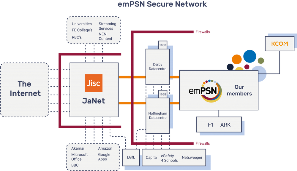

I'm told that it has to be this way because we have a Virgin connection (BT doesn't yet have fibre here) so Kcom set up the connection with Virgin business. To then get to the emPSN joint network, which most maintained schools are on in Nottingham we then have to go first through LgFL because of the virgin connection. We also have filtering by CaptalBytes provided through emPSN.
I'll try and attach a picture of the public network. This is the part that supposedly has a break somewhere that is only affecting schools with a virgin connection. They have put in some sort of temporary??? bypass which is then causing us to have a degraded connection. This temp bypass has been there longer than I have and is the part causing us the headache.
