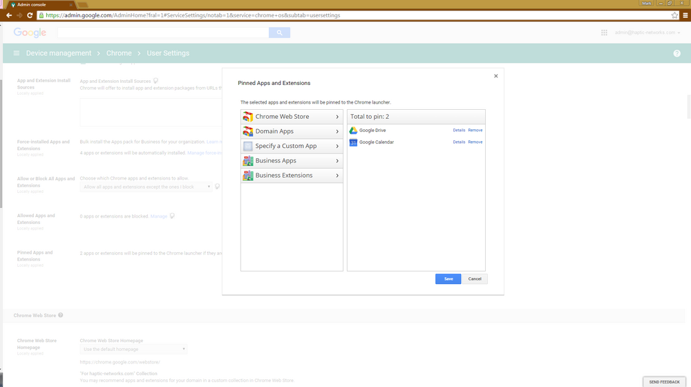

1) Go to Device Management-> Chrome -> User settings, you will then see an option for "Apps and Extensions" "Pinned Apps and Extensions"
here you can set which Apps are pinned to the Taskbar
2/3) Also under "Apps and Extensions" there a few methods of doing this, most straight forward approach would be to select (under "Allow or Block All Apps and Extensions") select "Block all apps and extensions except the ones I allow", then under "Allowed Apps and Extensions" select the Apps/ Extensions you would like to have available & visible.
