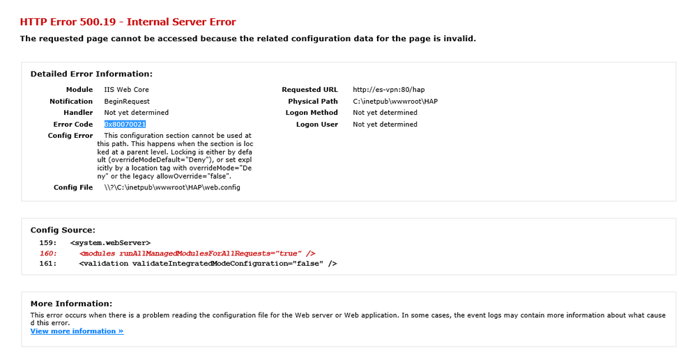

BonnyArmadillo Posted May 29, 2015 Posted May 29, 2015 Hi all, I have followed the HAP install video a couple of times and tried the install on a few occasions but can never get HAP to work. Every time I try and browse to the page i get the following error- 0x80070021 completely lost- help would be appreciated!

nickbro Posted May 30, 2015 Posted May 30, 2015 Quick search: %windir%\system32\inetsrv\appcmd.exe unlock config -section:system.webServer/modules
