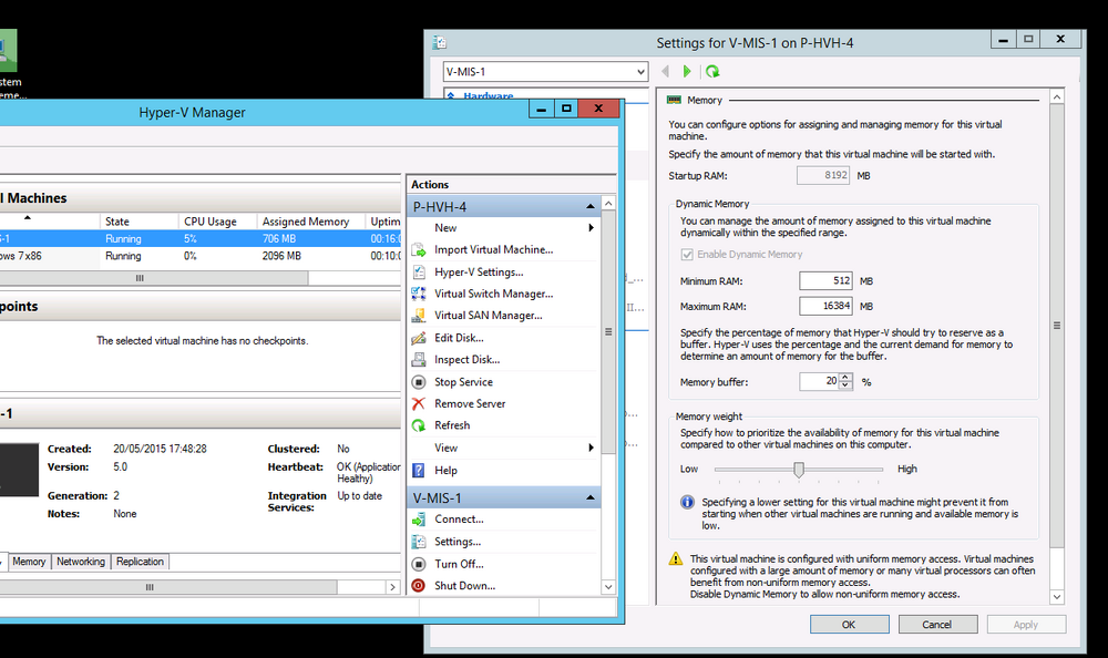

The allowcated memory 1606MB in hyper V is less than the startup RAM 4096MB !!
Host View
Guest View

Turning off dynamic memory had the effect I was expecting.
-Memory Usage in guest changed to 10% from 97%
-Allocated memory in hyper-v manager changed from 800MB to 8192MB
If dynamic memoery is enabled you see the following warning
"This virtual machine is configured with uniform memory access. Virtual machines configured with a large amount of memory or many virtial processors can often benefit from non-uniform memory access.
Disable Dynamic Memory to allow non-uniform memory access"
