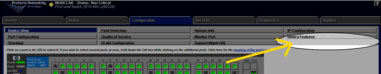

Can't see page to upload firmware on Procurve switch GUI
See image below - where the link should be is missing.. haven't got this on any other switch as the link is there, but I can't even see is on the GUI for this particular switch. Is there somewhere else where the link can be enabled (which would be bizarre if there were, but I am running out of ideas)?!

This isn't an older procurve though.. it's a 2810 model. We have other identical 2810 models, both 24 and 48 ports, and also 2510, 2610 and 2910 and have this button on all of them. I am just baffled why this switch doesn't have it in the interface, which is otherwise identical to the rest we have.

Did the update via TFTP and voila once the new firmware was on it had the upload/download button again, so I guess it must have been on such an early firmware release that the feature simply hadn't been made available then. All good now though!
