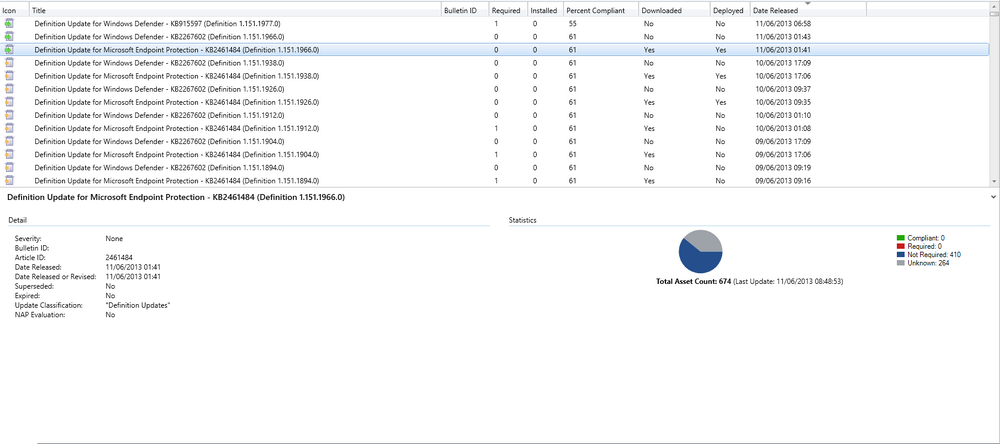

Yep no change. By the looks of it, the update might have been superseded
Just checked on my server and none of my updates for SCEP show a "required" count
Usually superseded updates go orange once SCCM knows there is a newer update...
