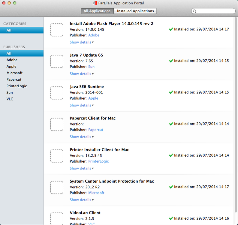

To be honest, it doesn't do very much for you. It gives you a visual indicator that the client is installed and that it's getting policies but not much else. It's still there thankfully (with a useful additional button which lets you trigger a client policy update from the Mac instead of having to do it from the SCCM console) but there is now an additional application called the Parallels Application Portal. This is their equivalent of the Software Center built into the Windows SCCM client. It looks like this:
Much like Software Center, it tells you what software has been assigned to the Mac. It lets you kick off software installations manually and it tells you when the software was installed. It supports optional installs as well as enforced ones and it detects whether a piece of software is installed even if it wasn't the PMA that installed it.
To do this, Parallels have started using Applications in the same way that the native Microsoft client does. This means that you have to download the Mac ConfigMgr tools and use the CMAppUtil to repackage the software into a format that the ConfigMgr console can understand. The extension is .cmmac, it's just a refactored ZIP file with an XML file and the PKG\MPKG\.app file in it. You could probably put one together yourself if you were feeling brave enough. When you create the cmmac file the repackaging software looks at the installer and it creates some detection rules which it uses to see if the software is installed or not.
The following paragraph is all supposition on my part but it explains the facts as I see them. Parallels seem to have created an extra service for the Mac side which runs an inventory of installed software. This agent scans the /Applications and /Library folders and looks for Info.plist files. If it finds one, it scans it and adds it to a database of some description. The agent then compares what's in the detection rules in your application on the ConfigMgr server with whats in the database on the local Mac and marks applications as installed depending on whether there's a match or not. This seems to work nicely but there is a caveat.
As I said above, when you create the cmmac file there is some kind of voodoo built into the packager which scans the installer or .app file and plumbs the detection rules into the cmmac file for you. When you create the application on the ConfigMgr server they all just automatically appear. Job done, right? Possibly not. When you create a cmmac file from a pkg file, it puts in loads of detection rules and generally speaking they're all and rules. When I created an installer for the latest Office service pack, the list scrolled; there must have been at least 15 rules in there. Unfortunately the Parallels agent doesn't seem pick up all of the things that the detection rules are looking for so if you leave the detection rules as they are, the Application Portal doesn't mark the software as installed. You therefore have to go in and either trim them down or create them from scratch. (Thinking back on it, it's quite possible that the native Microsoft agent had the same problem as it had a very annoying habit of trying to reinstall software that it had already installed) I've also come across a couple of packages which either sit in a location which the PMA doesn't index (such as /opt) or that have info.plist files that the agent can't or won't index (Oracle's Java is the main one here).
