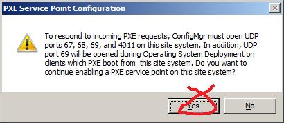

Get ready for a load of Next, Next, Next! On the "New Role" screen, highlight the PXE role and select it, click next. This will want you to confirm, so say yes.

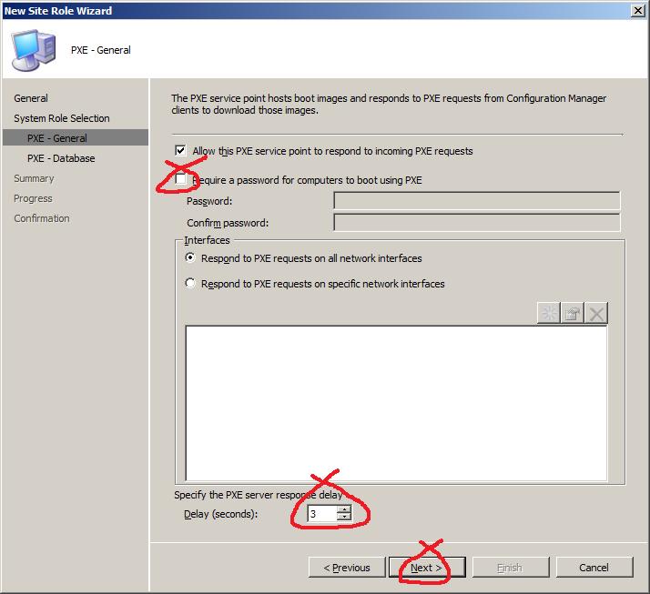

Up next, the PXE - General options page. For your testing, I would suggest that you remove the password requirement - but in production, you will want one of these. It stops little monkeys getting into your deployment system by mistake.
Now - if your server already has been used for WDS - and you are still using that actively whilst testing out SCCM - this bit is for you! By fiddling with the PXE server response settings - you can swap between which system you are using. For SCCM, this value should be less than the value listed in your Windows Deployment Services PXE delay, you can verify the WDS pxe delay by right clicking the WDS server and choose properties/PXE response Settings.
What we want to happen here is that SCCM answers the first PXE boot request(s) from a client and if they are not associated with a Task Sequence then let WDS take over with the PXE boot routine.

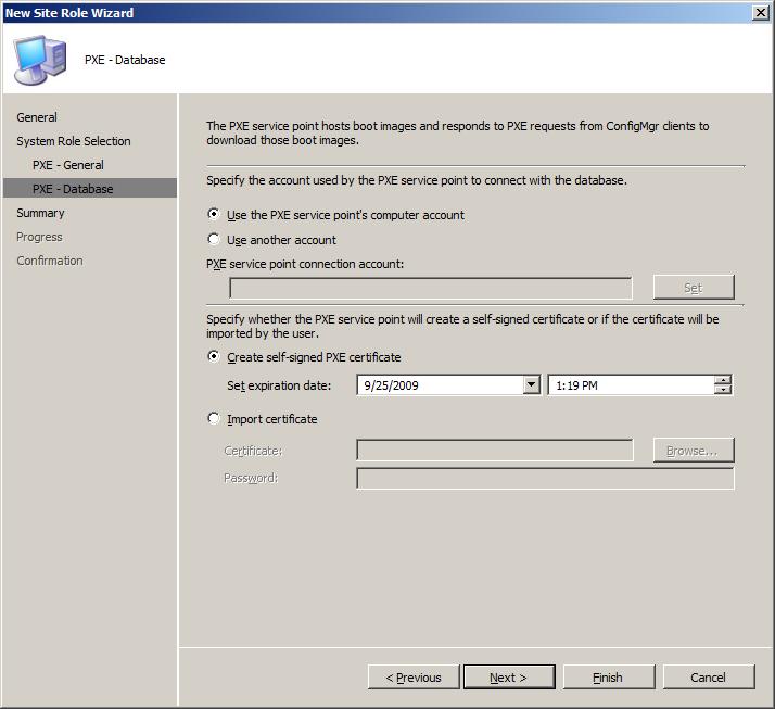

The above is rare though - but hey - its a useful insight into what is going on behind the scenes! Now, where were we? Ah yes, SCCM's PXE role - lets finish it off. Unless you can think of any real reason (I cant), then you will want to accept the PXE-database settings and click next. When dealing with the Certificate used for PXE, set the expiry to a long long long time into the future. The last thing you need is in a year is to have to renew it. Chances are, you will have forgotten about this setting by then - and will be head scratching why PXE booting isnt working! Save yourself the hassle then!!
