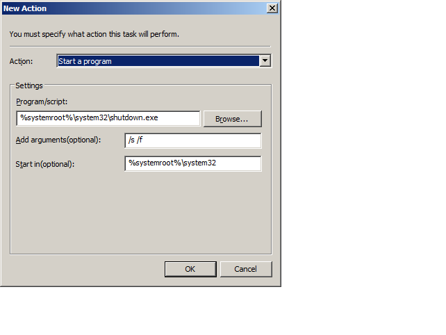

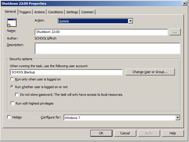

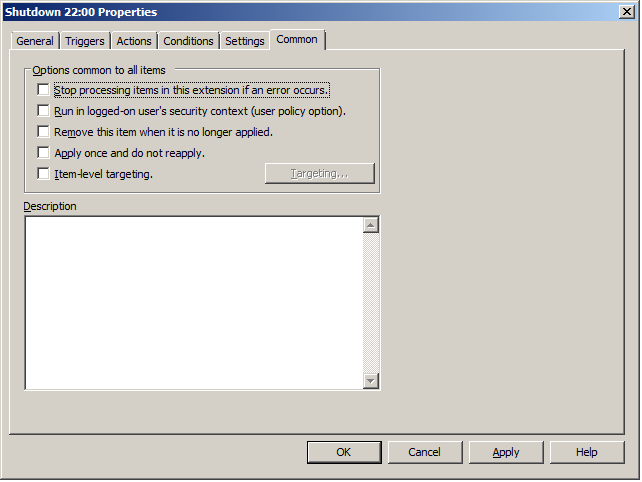

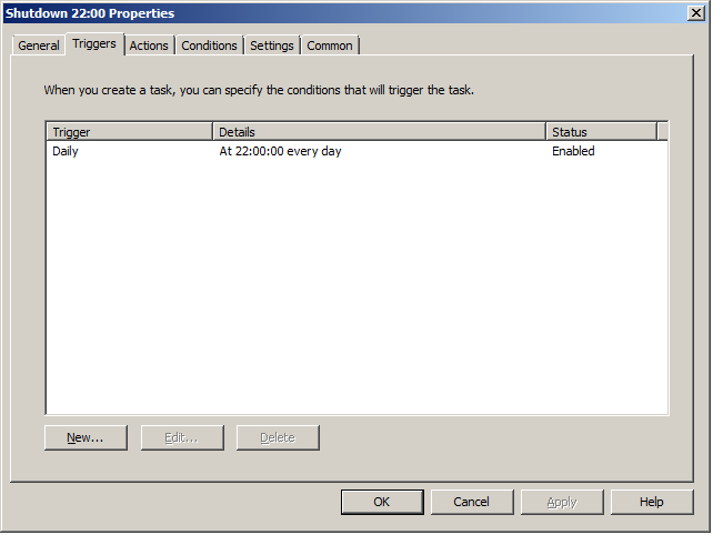

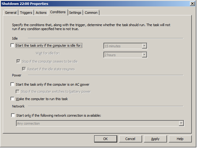

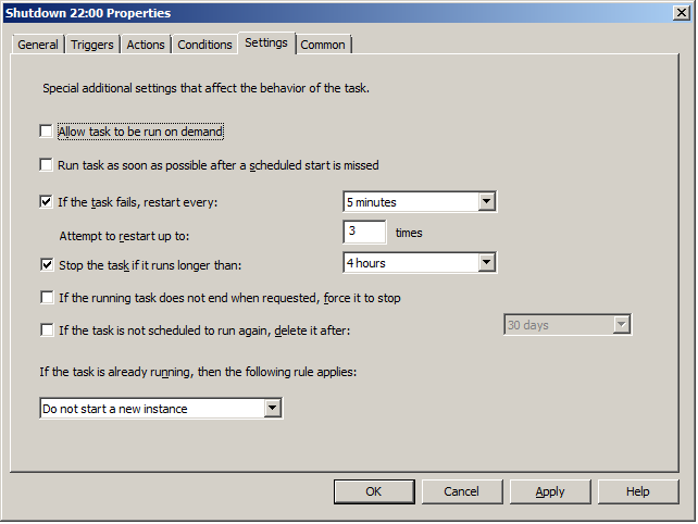

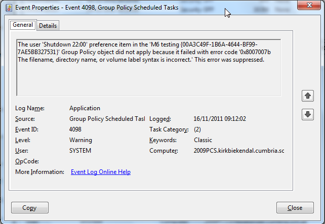

Finch7 Posted November 16, 2011 Posted November 16, 2011 (edited) Ok so I'm trying to deploy a scheduled task but having some difficulty. It's basically to shut down PCs at night. Here are some screen grabs of the preference settings. If some one who has this working and can spot any anomaly that'd be great. The error message reported in Event viewer.. "The user 'Shutdown 22:00' preference item in the 'M6 testing {00A3C49F-1B6A-4644-BF99-7AE5BB327531}' Group Policy object did not apply because it failed with error code '0x8007007b The filename, directory name, or volume label syntax is incorrect.' This error was suppressed." --- I've tried changing a lot of the syntax of the Action, removing the variables, Just can't seem to get the scheduled task created. The path there does point to shutdown.exe on the client and I've also manually created the task and it ran with no problems. I've also pulled this out of all other OUs so the only policies applying are the "M6 Testing" and default domain policy (a very Spartan policy) Tried as a computer and user preference Only been logging on as a domain Admin during testing. I've encountered this error while trying to get printers deployed via GPP too and never got a solution (had to stick with scripts for now). Currently some GPP do apply, like start menus, registry settings and shortcuts all currently in use in the live environment. All clients are windows 7 which I assume then GPP CSE are installed by default and running ok, I've not explored this but I'm starting to think that might be something to look at, not sure if CSE is needed for all the preferences or just some of them (the ones I'm having trouble with maybe?) I also enabled gpp scheduled task logging (computer policy system/group policies/logging) Here is the log. There's actually 3 tasks that should be created. 11-16 09:12:02.556 [pid=0x3b0,tid=0xdec] Entering ProcessGroupPolicyExSchedTasks() 2011-11-16 09:12:02.560 [pid=0x3b0,tid=0xdec] SOFTWARE\Policies\Microsoft\Windows\Group Policy\{AADCED64-746C-4633-A97C-D61349046527} 2011-11-16 09:12:02.562 [pid=0x3b0,tid=0xdec] BackgroundPriorityLevel ( 0 ) 2011-11-16 09:12:02.564 [pid=0x3b0,tid=0xdec] DisableRSoP ( 0 ) 2011-11-16 09:12:02.566 [pid=0x3b0,tid=0xdec] LogLevel ( 2 ) 2011-11-16 09:12:02.568 [pid=0x3b0,tid=0xdec] Command subsystem initialized. [sUCCEEDED(S_FALSE)] 2011-11-16 09:12:02.616 [pid=0x3b0,tid=0xdec] Background priority set to 0 (Idle). 2011-11-16 09:12:02.618 [pid=0x3b0,tid=0xdec] ----- Parameters 2011-11-16 09:12:02.620 [pid=0x3b0,tid=0xdec] CSE GUID : {AADCED64-746C-4633-A97C-D61349046527} 2011-11-16 09:12:02.622 [pid=0x3b0,tid=0xdec] Flags : ( ) GPO_INFO_FLAG_MACHINE - Apply machine policy rather than user policy 2011-11-16 09:12:02.624 [pid=0x3b0,tid=0xdec] ( X ) GPO_INFO_FLAG_BACKGROUND - Background refresh of policy (ok to do slow stuff) 2011-11-16 09:12:02.625 [pid=0x3b0,tid=0xdec] ( ) GPO_INFO_FLAG_SLOWLINK - Policy is being applied across a slow link 2011-11-16 09:12:02.627 [pid=0x3b0,tid=0xdec] ( ) GPO_INFO_FLAG_VERBOSE - Verbose output to the eventlog 2011-11-16 09:12:02.628 [pid=0x3b0,tid=0xdec] ( ) GPO_INFO_FLAG_NOCHANGES - No changes were detected to the Group Policy Objects 2011-11-16 09:12:02.629 [pid=0x3b0,tid=0xdec] ( ) GPO_INFO_FLAG_LINKTRANSITION - A change in link speed was detected between previous policy application and current policy application 2011-11-16 09:12:02.631 [pid=0x3b0,tid=0xdec] ( ) GPO_INFO_FLAG_LOGRSOP_TRANSITION - A change in RSoP logging was detected between the application of the previous policy and the application of the current policy. 2011-11-16 09:12:02.632 [pid=0x3b0,tid=0xdec] ( X ) GPO_INFO_FLAG_FORCED_REFRESH - Forced Refresh is being applied. redo policies. 2011-11-16 09:12:02.634 [pid=0x3b0,tid=0xdec] ( ) GPO_INFO_FLAG_SAFEMODE_BOOT - windows safe mode boot flag 2011-11-16 09:12:02.635 [pid=0x3b0,tid=0xdec] ( ) GPO_INFO_FLAG_ASYNC_FOREGROUND - Asynchronous foreground refresh of policy 2011-11-16 09:12:02.637 [pid=0x3b0,tid=0xdec] Token (computer or user SID): S-1-5-21-1037851856-2007117648-2118856591-500 2011-11-16 09:12:02.639 [pid=0x3b0,tid=0xdec] Abort Flag : Yes (0x0163c6d0) 2011-11-16 09:12:02.641 [pid=0x3b0,tid=0xdec] HKey Root : Yes (0x00000ad8) 2011-11-16 09:12:02.643 [pid=0x3b0,tid=0xdec] Deleted GPO List : No 2011-11-16 09:12:02.645 [pid=0x3b0,tid=0xdec] Changed GPO List : Yes 2011-11-16 09:12:02.647 [pid=0x3b0,tid=0xdec] Asynchronous Processing : Yes 2011-11-16 09:12:02.650 [pid=0x3b0,tid=0xdec] Status Callback : No (0x00000000) 2011-11-16 09:12:02.652 [pid=0x3b0,tid=0xdec] WMI namespace : Yes (0x04530e40) 2011-11-16 09:12:02.654 [pid=0x3b0,tid=0xdec] RSoP Status : Yes (0x05b1fc14) 2011-11-16 09:12:02.656 [pid=0x3b0,tid=0xdec] Planning Mode Site : (none) 2011-11-16 09:12:02.658 [pid=0x3b0,tid=0xdec] Computer Target : No (0x00000000) 2011-11-16 09:12:02.660 [pid=0x3b0,tid=0xdec] User Target : No (0x00000000) 2011-11-16 09:12:02.663 [pid=0x3b0,tid=0xdec] Calculated list relevance. [sUCCEEDED(S_FALSE)] 2011-11-16 09:12:02.665 [pid=0x3b0,tid=0xdec] ----- Changed - 0 2011-11-16 09:12:02.667 [pid=0x3b0,tid=0xdec] Options : ( ) GPO_FLAG_DISABLE - This GPO is disabled. 2011-11-16 09:12:02.669 [pid=0x3b0,tid=0xdec] ( ) GPO_FLAG_FORCE - Do not override the settings in this GPO with settings in a subsequent GPO. 2011-11-16 09:12:02.672 [pid=0x3b0,tid=0xdec] Options (raw) : 0x00000000 2011-11-16 09:12:02.674 [pid=0x3b0,tid=0xdec] Version : 4849738 (0x004a004a) 2011-11-16 09:12:02.676 [pid=0x3b0,tid=0xdec] GPC : LDAP://CN=User,cn={00A3C49F-1B6A-4644-BF99-7AE5BB327531},cn=policies,cn=system,DC=kirkbiekendal,DC=cumbria,DC=sch,DC=uk 2011-11-16 09:12:02.678 [pid=0x3b0,tid=0xdec] GPT : \\kirkbiekendal.cumbria.sch.uk\SysVol\kirkbiekendal.cumbria.sch.uk\Policies\{00A3C49F-1B6A-4644-BF99-7AE5BB327531}\User 2011-11-16 09:12:02.680 [pid=0x3b0,tid=0xdec] GPO Display Name : M6 testing 2011-11-16 09:12:02.682 [pid=0x3b0,tid=0xdec] GPO Name : {00A3C49F-1B6A-4644-BF99-7AE5BB327531} 2011-11-16 09:12:02.684 [pid=0x3b0,tid=0xdec] GPO Link : ( ) GPLinkUnknown - No link information is available. 2011-11-16 09:12:02.686 [pid=0x3b0,tid=0xdec] ( ) GPLinkMachine - The GPO is linked to a computer (local or remote). 2011-11-16 09:12:02.688 [pid=0x3b0,tid=0xdec] ( ) GPLinkSite - The GPO is linked to a site. 2011-11-16 09:12:02.689 [pid=0x3b0,tid=0xdec] ( ) GPLinkDomain - The GPO is linked to a domain. 2011-11-16 09:12:02.691 [pid=0x3b0,tid=0xdec] ( X ) GPLinkOrganizationalUnit - The GPO is linked to an organizational unit. 2011-11-16 09:12:02.694 [pid=0x3b0,tid=0xdec] ( ) GP Link Error 2011-11-16 09:12:02.696 [pid=0x3b0,tid=0xdec] lParam : 0x00000000 2011-11-16 09:12:02.698 [pid=0x3b0,tid=0xdec] Prev GPO : No 2011-11-16 09:12:02.700 [pid=0x3b0,tid=0xdec] Next GPO : No 2011-11-16 09:12:02.702 [pid=0x3b0,tid=0xdec] Extensions : [{00000000-0000-0000-0000-000000000000}{CAB54552-DEEA-4691-817E-ED4A4D1AFC72}][{AADCED64-746C-4633-A97C-D61349046527}{CAB54552-DEEA-4691-817E-ED4A4D1AFC72}] 2011-11-16 09:12:02.703 [pid=0x3b0,tid=0xdec] lParam2 : 0x088d898c 2011-11-16 09:12:02.705 [pid=0x3b0,tid=0xdec] Link : LDAP://OU=test,DC=kirkbiekendal,DC=cumbria,DC=sch,DC=uk 2011-11-16 09:12:02.722 [pid=0x3b0,tid=0xdec] RunOnce value created [sUCCEEDED(S_FALSE)] 2011-11-16 09:12:02.727 [pid=0x3b0,tid=0xdec] Read GPE XML data file (4955 bytes total). 2011-11-16 09:12:02.730 [pid=0x3b0,tid=0xdec] RunOnce value created [sUCCEEDED(S_FALSE)] 2011-11-16 09:12:02.738 [pid=0x3b0,tid=0xdec] Properties handled. [ hr = 0x8007007b "The filename, directory name, or volume label syntax is incorrect." ] 2011-11-16 09:12:02.746 [pid=0x3b0,tid=0xdec] Error suppressed. [ hr = 0x8007007b "The filename, directory name, or volume label syntax is incorrect." ] 2011-11-16 09:12:02.809 [pid=0x3b0,tid=0xdec] Properties handled. [ hr = 0x8007007b "The filename, directory name, or volume label syntax is incorrect." ] 2011-11-16 09:12:02.818 [pid=0x3b0,tid=0xdec] Error suppressed. [ hr = 0x8007007b "The filename, directory name, or volume label syntax is incorrect." ] 2011-11-16 09:12:02.884 [pid=0x3b0,tid=0xdec] Properties handled. [ hr = 0x8007007b "The filename, directory name, or volume label syntax is incorrect." ] 2011-11-16 09:12:02.892 [pid=0x3b0,tid=0xdec] Error suppressed. [ hr = 0x8007007b "The filename, directory name, or volume label syntax is incorrect." ] 2011-11-16 09:12:02.901 [pid=0x3b0,tid=0xdec] Completed get next GPO. [sUCCEEDED(S_FALSE)] 2011-11-16 09:12:02.904 [pid=0x3b0,tid=0xdec] WQL : SELECT * FROM RSOP_PolmkrSetting WHERE polmkrBaseCseGuid = "{AADCED64-746C-4633-A97C-D61349046527}" 2011-11-16 09:12:02.944 [pid=0x3b0,tid=0xdec] Purged 3 old RSoP entries. 2011-11-16 09:12:02.946 [pid=0x3b0,tid=0xdec] Logging 3 new RSoP entries. 2011-11-16 09:12:02.952 [pid=0x3b0,tid=0xdec] RSoP Entry 0 2011-11-16 09:12:02.969 [pid=0x3b0,tid=0xdec] RSoP Entry 1 2011-11-16 09:12:02.985 [pid=0x3b0,tid=0xdec] RSoP Entry 2 2011-11-16 09:12:02.998 [pid=0x3b0,tid=0xdec] Completed get GPO list. [sUCCEEDED(S_FALSE)] 2011-11-16 09:12:03.007 [pid=0x3b0,tid=0xdec] Leaving ProcessGroupPolicyExSchedTasks() returned 0x00000000 SOLVED Would be nice if that pop up appeared when creating scheduled tasks in GPO. Thanks for the help Edited November 16, 2011 by Finch7 SOLVED 1

Kogelkopper Posted November 16, 2011 Posted November 16, 2011 Finch, Can you check if the following works: replace the %systemroot%\system32\shutdown.exe with C:\Windows\System32\shutdown.exe in the program script area and remove %systemroot%\system32 and leave it (blanc). And test again?
Finch7 Posted November 16, 2011 Author Posted November 16, 2011 Yep tried that (and again just now to double check) and numerous other permutations. I really don't think it's syntax related any more. Especially as I can manually create the same job with the same syntax and run it successfully.

Finch7 Posted November 16, 2011 Author Posted November 16, 2011 Thanks but you may want to hold off. the ":" character is not allowed in names. When you create the task through gpo it doesn't care to inform you that nor does any of the reams of documents I ploughed through. It's only just now when I tried recreating the job again manually, to the exact detail including name it tells me. Thanks for your efforts people.
